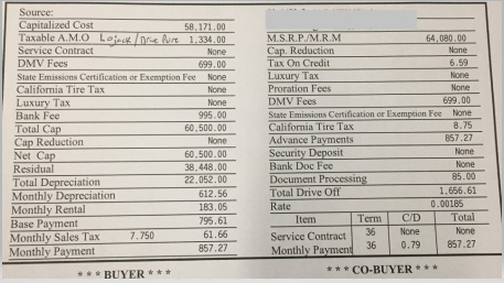

Deal check/advice: Volvo XC90 - trying to learn the process
I’m looking to possibly get some assistance on how I can pick through this lease sheet I received. I’ve been researching on this forum to learn how to better equip myself to work through these lease deals.
From what I see here, they are using their entire incentive options to get to their selling price, with nothing extra after that to me. And from what I’ve gathered from Edmunds, the MF should be .0015, so they are marking up their MF to .00185.
I’m trying to fill in the Lease Calculator from this sheet, but I still can’t seem to get it to match.
Needless to say, I see that this is a bad lease deal, but I’m struggling to find out how to negotiate properly when I’m seeing these deals that look like they are structured for the max to the dealer.
Any direction would be great, I’m doing the research as much as I can but I’m wondering if I’m after a car that is just not getting good deals at the moment. I’ve seen 2 other lease sheets in No. Cal very similar to this.
BTW: 2020 Volvo T6 Momentum 7 Pass. Adv. pck.
Heads up. The first quote you get from a Dealer is ALWAYS a deal you can improve. It’s a starting point. I use it to breakdown the deal into its parts and map out a counter offer plan.
You know more than you give your self credit. I see a good deal in your future.
You have a good handle on what to do. Follow this roadmap on your Volvo deal.
Volvo’s go-to-market strategy is a little different than most car makers. Volvo’s lease program features direct-to-dealer incentives - the kind of incentives that give buyers the impression that the dealer is giving them a huge discount. The buyer is in fact getting a welcomed discount but it’s not all coming from the dealer. Confused? Good - confusion gives the car dealers the upper hand. Often, dealers are not forthcoming about how they come to the discount they offer you. If you want a great deal - you must break-down the dealer’s total discount into its parts and know how each component contributes to a great deal.
The challenge with direct-to-dealer incentives is it masks the discount you are getting from the dealer and the discount you are getting straight from Volvo. When you get an offer from an Volvo dealer you need to break down the discount your getting into two parts: i. how much is the dealer discounting the price and ii. how much is Volvo discounting the price.
i. Dealer Discount: the dealer should reach into his pocket and give you a discount - this comes from the dealer’s potential profit on your deal. Unfortunately, this is the win-lose part of the leasing game.
ii. Direct-to-Dealer Incentive. Each month Volvo gives dealers funds to discount the price of new cars. This varies by model and it varies by trims within a model. You can find this information on Edmunds (other trunk money is not made public). Dealers may consider withholding some of the incentive from you to improve their deal profit. Your goal is to know it’s there and reflect it ALL in your selling price offer - plus the discount you want from the dealer.
How to use the LH calculator:
  1. Selling Price input. You only input the dealer discount here. MSRP minus DEALER DISCOUNT. Do NOT input msrp minus dealer discount minus direct-to-dealer incentive here.
  2. Untaxed Incentive input: This where you reflect the direct-to-dealer discount.
  3. Taxed Incentives input: This is where you reflect your direct-to-consumer incentives: loyalty, conquest, college grad, etc.
Plug figures used to illustrate how to break down your price & incentives.
$40,000 MSRP
$ 3,000 Dealer Discount
$37,000 Pre-Incentive Selling Price ► Selling Price input into calculator
$ 6,000 Direct-to-Dealer Cash ► Untaxed Incentive input into calculator
$31,000 Dealer’s Selling Price Offer
$ 1,000 Loyalty Cash
$ 750 Healthcare Worker
$ 1,750 Total Direct-to-Consumer ► Taxed Incentive input into calculator
Your first step should always be determining what a good deal is BEFORE you talk to a dealer. Put together your own deal so you know what you should be targeting. Then, when you look at a deal like this, you can easily see all the areas where there is room for improvement.

So I get the difference now between dealer discounts vs direct-to-dealer incentives.
My question is how do I come to understand the difference when the dealer gives me this?
Quote: The MSRP is $64,080, and to avoid doing back and forth negotiating, we can lower that price down to $58,171 for you.
Is this where edmunds research comes in?
This is actually pretty fun to research…
Work backwards:
40,000 MSRP
3,000 minus Direct-to-dealer incentive (edmunds or Volvo build a car tool)
= 37,000 Sub-total
minus 31,000 Selling Price offer from Dealer
= 6,000 Dealer Discount
My brain works better when I rearrange the numbers like this:
$40,000 MSRP
