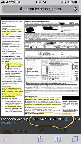

Hi there! Read the discussion thus far and was wondering if what I attached would help. Please note that this is preliminary numbers plugged in by the dealership so I can see what the numbers are.
What items do you think should be taken off, if any?

@Laker24 @taikis How does this look? Please critique and ask questions if things are unclear.
Probably will want to right click and ‘view image’

@chrishs2000 Thanks very much for putting this together. It is a valuable reference and I’m sure will become a Sticky for the community.
Just one ask, can you upload a better resolution of the 1st image? It very blurry and when its thrown a word doc or pdf to print, it really can’t be seen well. The 2nd image is better and can be read after printing.
It’s scaling down on the forum preview but it’s a full size JPG output from a Word file. Save it as a photo to your computer by right clicking the image.

I did a right click and copy image, then pasted into word, and its blurry.
Just tried downloading / saving image to desktop, inserted and same result.
Maybe you can upload your word version to Google docs and link that here.
Don’t copy it, you’re copying the preview. Save the actual picture. It’s a 2.76MB 4951x6526 JPG.
For line item 9A.1, suggestion to keep CCR to $0 is to make sure that in case of totaled vehicle, we don’t loose that CCR $?
Got it, thanks again
Correct. CCR = Down Payment.
In case of a total loss, GAP insurance covers the difference between your payoff and the value of the vehicle. If the appraised value of the vehicle is less than your payoff, any cap cost reduction will be lost. On some brands like Hyundai/Kia, we’ve seen that even if the appraised value is higher they will keep the money for themselves. Regardless, there’s very little financial incentive to make a down payment.
