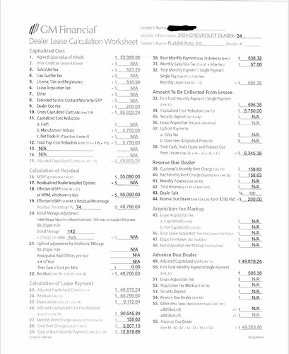

Newbie here In WA. I am dealing with Chev dealer on 2024 Blazer EV RS, and found out there are difference on Residual and MF between RateFindr and a quote from dealer. I used VIN to get data, and dealer confirmed data is directly from GM financial. Residual is 76% vs 74%, and MF is 0.00137917 vs 0.00175. In addition to that, there are quite of missing rebates which are shown as stackable from RateFindr.
Is this just dealer markup? Just walk away if dealer refuses to match? I am wondering how others deals with this kind of things.
Calculator is what I typed based on RateFindr with dealer MSRP/Selling price/Licensing fee/Doc fee.
Quote from dealer is below.
Thanks for taking a look! Sounds like dealer marked up both of them. Dealer mentioned 76 res is 10K. I replied to dealer about those, and will wait what they will say.
Thanks for the info. They are using GM financial as shown in quote, and yeah this become strange. I just asked them to use 76, and will see how they respond.
Thanks for the analysis! $200 is doc fee dealer is charging, and yes I haven’t seen acquisition fee from their quote, but it is shown up by default in Ratefindr. So, I can remove this from my calculator then. My plan is correcting MF and RV, and checking out maximum rebates stacking, then negotiate selling price down; I guess 10%.
I’m aware of that. I also know that the dealer is receiving a 200 flat fee reserve which is profit for the dealership… probably F&I.

Ratefindr gives the default values for the bank, not anything model specific. It wouldn’t show if there is an acq fee waiver on a specific vehicle, as is the case here with the evs.
Dealer cannot markup the RV. Your dealer discount is too small. That is something you should be negotiating. If that’s not possible, you should walk away.

It looks like mistake from dealer. Yup, I am still trying to get rebates sorted out now, and will start negotiating selling price based on Edmunds suggested price.
I would suggest looking at the signed deals from LH and see what dealer discount people are getting pre-incentive. E.g., My Blazer LT last year was almost 13% discount pre-incentive. I would assume 8-10% dealer discount would still be possible.
