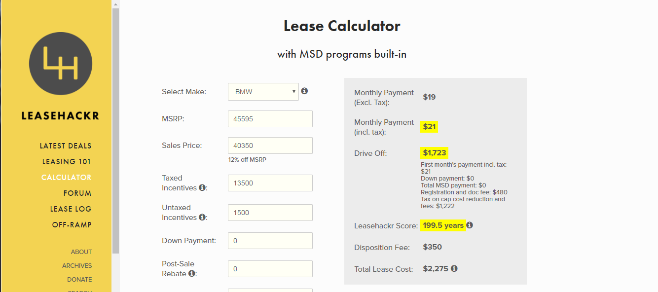

Okay so am I going crazy? I think I can get this deal for $21 a month because I live in CO. In CO, we also have a clean vehicle rebate, but for the i3 it’s $6000. On top of that, I read on the Colorado rebate website that “some manufacturers” actually can provide this an an incentive on top of the federal credit, so I wouldn’t even have to put the money down and then wait to file next year.
If I do the exact same deal as OP, including the corp fleet discount (which I can get through work), my total per month comes to $21 including tax, with ~$1,700 due at signing to cover first month payment, taxes on incentives, etc.
See my calculator below:
Notice how I combined the $6k colorado rebate as a taxed incentive. Even if I had to put this down as a down payment and then get the money back later, it would still only be $21 a month. Could this actually work? I feel like CO BMW dealers will definitely know about this and won’t let me walk out of there with 12% off MSRP before any discounts.
Please let me know if I’m going nuts or if this is an actual good deal.
Sorry for lease in CO you only get $2k. The purchase rebate is $5k. BMWF will not accept the sign over of the credit you will have to file for it.
Also on the lease BMWF only passes on 4k of the 7.5k federal incentive.
