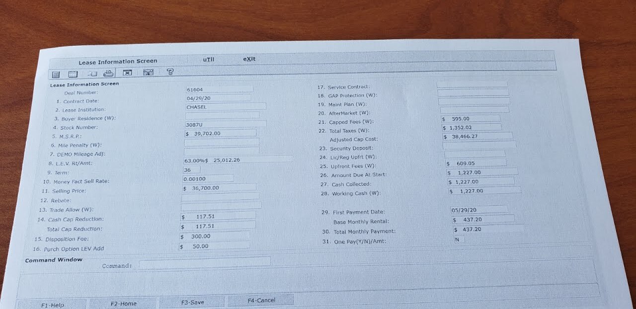

Got a quote and cannot seem to match the Lease Calculator with the dealer’s quote:
I’m getting $386 vs $437.20
What am I missing?
Thanks.
The DAS amounts are different

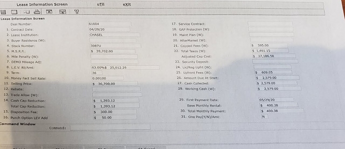

Hi Max,
I’ve attached the updated quote that added the taxes to the DAS.
I used the Leasehackr Calculator and still get a difference $386 vs the dealer’s $406:
The item in their quote that I have not included is the “cap cost reduction”. I’ve read that cap cost reduction is a down payment to reduce the monthly payment, but I’ve told the dealer no “down payment”. Is the “Cash Cap Reduction” of $1393.12 in their quote something else?
Thanks.
You’ve removed the $595 acquisition fee. Gotta have that in there.
They’re rolling fees and taxes into the cap cost and then doing a cap cost reduction. It’s the no different than paying them up front. Either way, you don’t want to pay them up front.
