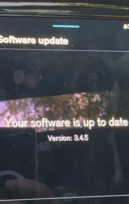

When I picked up my XC90, they installed a software update that wasn’t available over the air (OTA) at the time; the latest version available was 3.3.16, but they updated me to version 3.4.5.
The audio reset issue seems to be resolved. The audio settings had not reset yet it’s almost a week since I got it back (I’ll make an update to my post if it happens agian).
However, the signal issue still occurs, but it resets automatically now. Looks like they incorporated a code to autoreset network if there is no signal for a few minutes. So, when I turn on the car, I get updated traffic information and ETAs about five minutes into my drive. At least I don’t have to hold the button myself while driving, but this is still ridiculous.

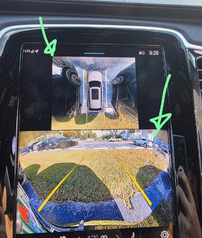

There’s a new feature in this version that I really like. When you’re in reverse, the screen splits into two, showing both the rear view and a 360-degree view simultaneously. This is an excellent idea. When you switch back to Drive, the 360-degree view remains full screen, which is helpful for parallel parking, until you accelerate further or turn off the car.
One of my biggest gripes was hitting the tiny “360” button after I shift into reverse. I can’t wait to get the update!!

Did they push 3.5.14 to your unit? They just did via OTA to my 2025.5 XC90.
I’m running 3.3.16
Check under Car Software in the App - 3.3.16 is from November. There have been several updates including one on June 2nd that will be available OTA in 0-3 weeks
I don’t think they’ve pushed them out via OTA for everyone. My C40 and T8 XC90 both have 3.3.16 despite trying to refresh/check for updates in the system settings.
My understanding is it’s a rolling update.

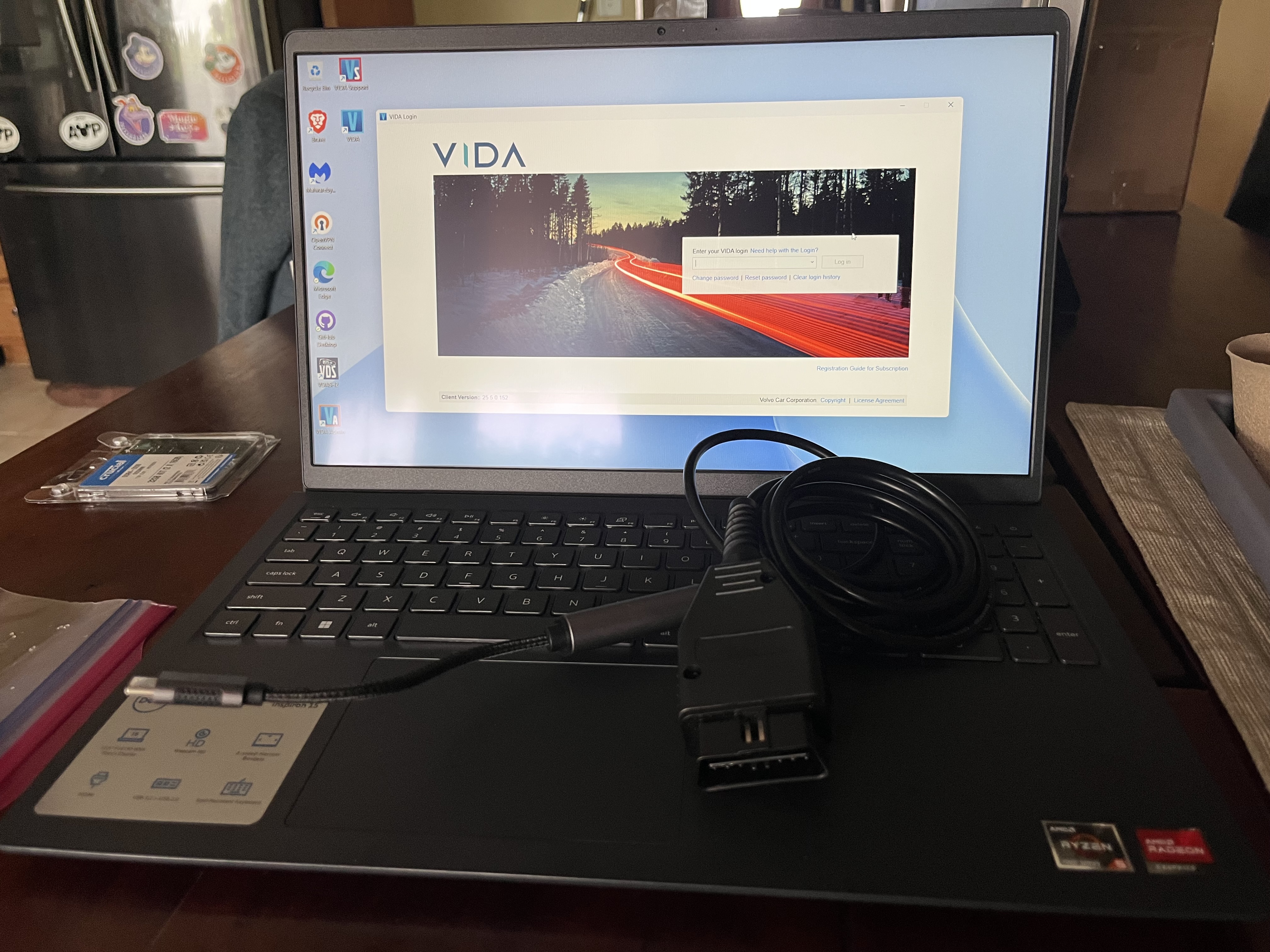

I built my own vida rig so I can perform my own workshop updates, which I’m off to do now
