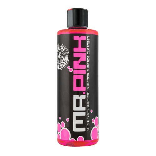

Many folks allege that they’re relabels of brands like Warner Instafinish sold at various dilution rates for 1.5x+ the cost.
Compare:
$40 for a gallon of this:
vs. $25 for a gallon of
The extra savage part is they allegedly dilute their source chemicals, too, even going so far as to sell the same base formula at different dilution strengths as different products… So consumers are paying more for even less product!
Not sure if the above is true or not, but that, plus the fact that they’re clearly experts at selling things (with margins like this everything is always on sale!) was enough to make me stay away.
