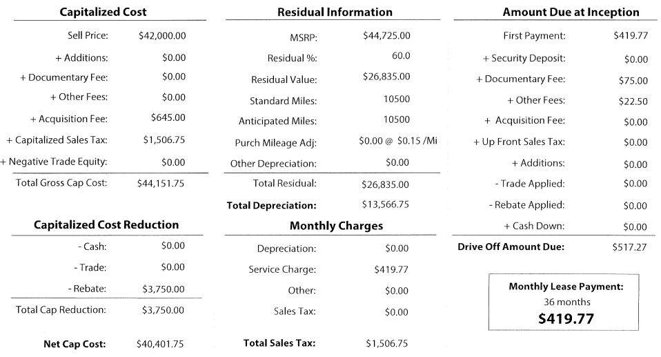

2020 Ford Explorer XLT 4WD w/ 202A and Comfort Package. $399/mo, 36/10.5k, $600 DAS. Details attached. Thoughts? Added a calculator link but can’t get it completely accurate since I’m in NY and rolling taxes into monthly

I’m pretty sure its Total before Discounts when it comes to Fords. That’s how it’s been in the past with the F150 deals posted on here. Can you post the lease worksheet quotes you are getting from the dealers?
The MSRP is listed as Total After Discounts: $44725.
Do you have a copy of the other dealer that calculating it the other way?

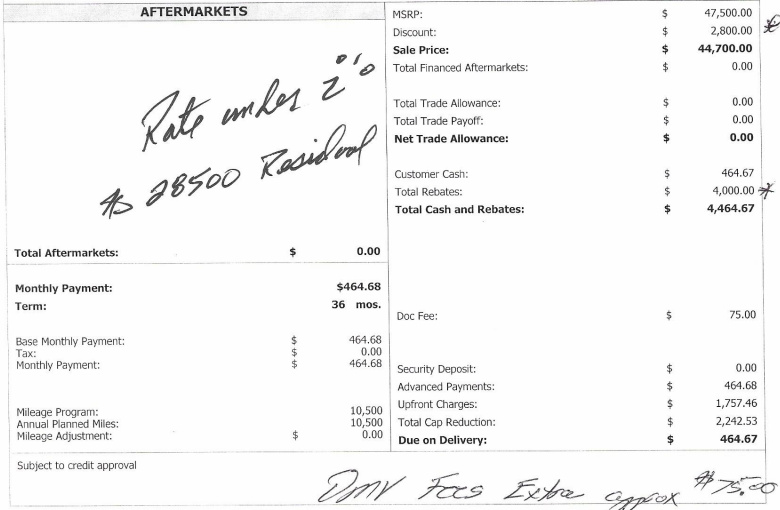

Different equipment package but showing the pre discount MSRP. Residual is hand written but based off the pre discount MSRP.

Residual is based on higher number before option package discount, same with GM. But negotiate your 10% discount on the blue box.

Guess I’m confused how they could provide a worksheet with incorrect MSRP and residual?
I’ve reached out to between 6-8 dealers. I’m in upstate NY.
The msrp is correct, they just split the discount off and put in in your discount column, so it looks like they’re giving you $2800 off when it’s really only $1800.
I provided two different quotes. One dealer did it one way and the other did the opposite. That’s why I’m confused as to which way is actually correct.
FWIW, it appears the lease estimate on Ford’s website uses the blue box MSRP which includes the equipment discount
Here is the X-Plan data for a 2020 Explorer XLT. It suggest there is only about 4% between MSRP and invoice which is in alignment with the discount you are showing on the optioned vehicle. Looks like you maybe missing some rebates however ($250) however that is mostly maid up with very reasonable doc/other fees. This seems like a pretty good deal to me, nonwithstanding MF and RV.
Spoke to the dealer who provided the discounted MSRP and a lower RV on the lease worksheet, they said it was an oversight on their end and apologized.
