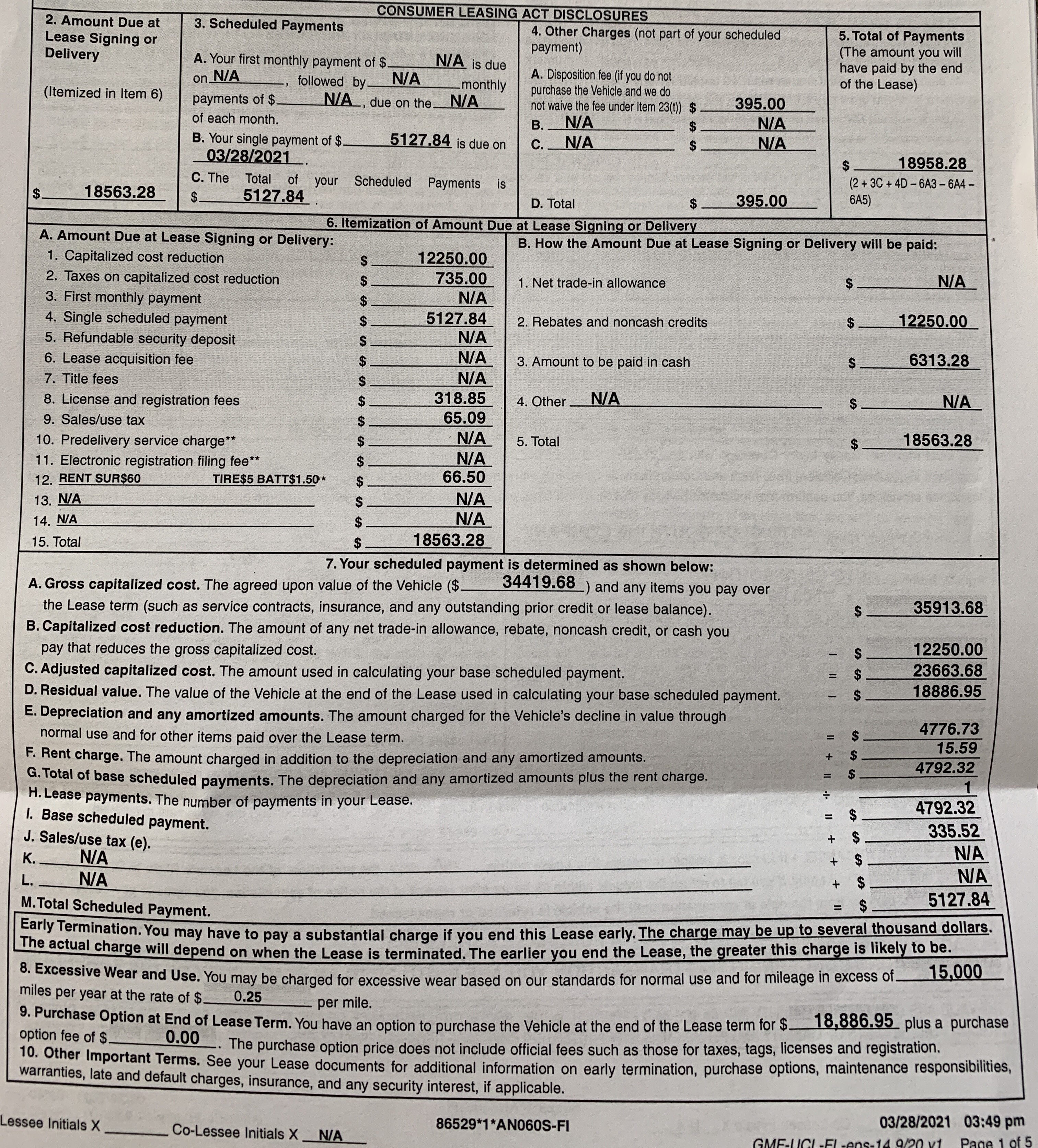

Ill soon be commuting again, so needed an ultra low cost point A to B car. On a whim I contacted a local Chevy dealer yesterday and signed today. This was one of the easiest leases I think I have done (aka I put forth close to zero effort) and was in and out at the dealer in less than an hour and they even handled all of the registration/plates (which is the norm in FL as most dealers are also DMV agents with a stash of permanent license plates).
2020 Chevrolet Bolt LT
DCFC
Comfort and Convenience
Driver Confidence I
Driver Confidence II
Cajun Red Tintcoat
Dealer applied window tint
MSRP: $40,185
Selling Price: $34,419.68 (14.35% discount)
Monthly Payment: $0
Drive-Off Amount: $6313.28 one pay ($175.37 effective monthly)
Months: 36
Annual Mileage: 15k
MF: .00001
Residual: 47%
Incentives: $12,250 ($5750 lease cash, $2000 bonus lease cash, $1500 lease loyalty/conquest, $3000 Costco). I also have GM Supplier, so the supplier discount is part of the sales price discount and the value is unknown.
Dealer Fee: $799
Region: Florida
The calculator is correct on the total cost, but the values for taxes are too high and the lease cost is too low, but it all comes out in the wash.
For Florida, without any additional local/state/utility incentives, I think this is moderately good. I suspect it’s relatively close to some of the canned California lease deals that get dropped periodically. I also need the miles for commuting, so decided it was better just to get those all upfront.
