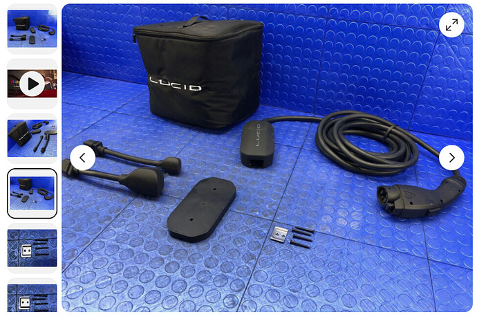

I was also recommended this as I am looking into one for a Lucid:

And this is portable? So I can charge it at home and use it on the road?
Actually, why didn’t your lucid come with this? I thought it was standard equipment?

But still, I thought Lucid’s shipped with a mobile connector? Not sure why you didn’t get one?
