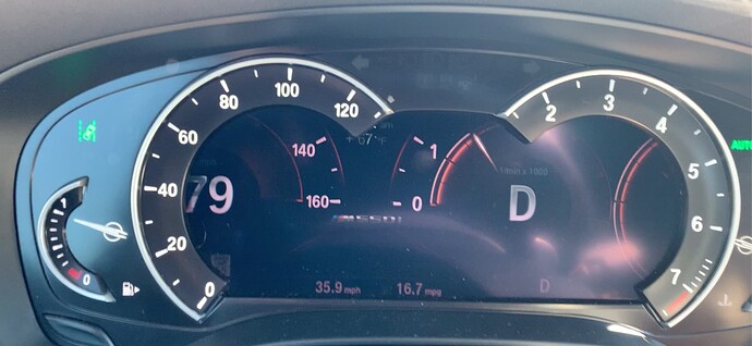

Thinking further on my end since I created the thread, I also had a one-off issue with the instrument cluster.
Beyond the problem that’s obvious in the photo, it was also flickering constantly. Restarting the car resolved this, and there hasn’t been a recurrence.
Seems more like a separate problem than a related one. I haven’t taken the car in for this because the symptom is no longer there.

Oh we had that same thing happen once in our instrument cluster! It actually persisted for like two days which was really weird. It eventually fixed itself but I remember thinking how weird it was when my wife came home and was like, “so this happened today…” Never did happen again, though.
