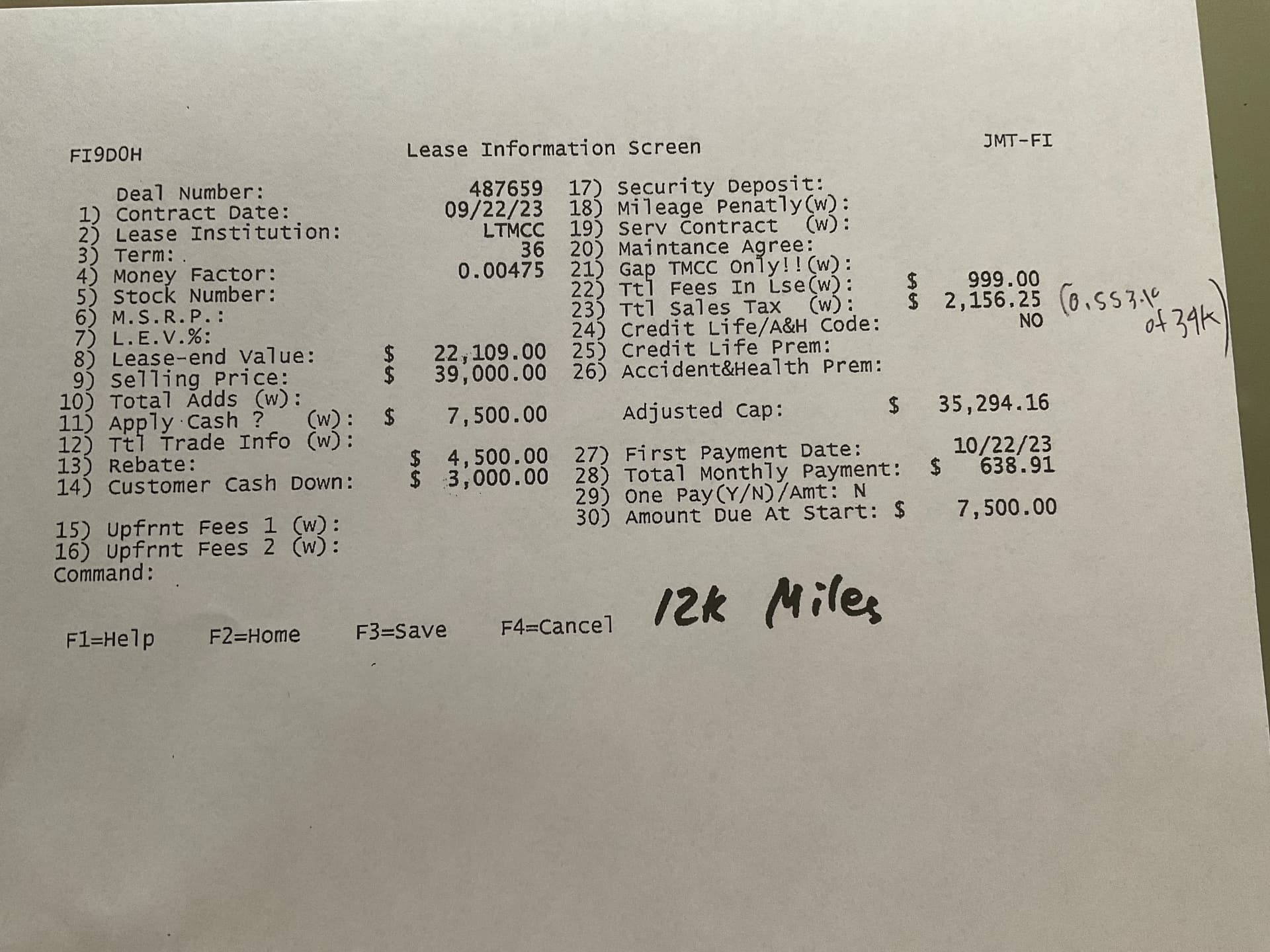

Here’s the numbers my dealer gave for the lease:
What has me concerned is that ratefindr shows a residual of 64% ($24,960). but the quote from the dealer of $22109 for “Final Value” is only 56.69% of $39k. What is the mathematical formula for converting “Final Value” to “Residual Value” since those numbers don’t seem to be the same? If I subtract the tax and origin fee from $24,960 that yields $22,154, which is close to the dealer’s final value of $22109; could that be the formula?
BTW, I’m also assuming that the $999 for 23) Ttl fees in lease (w) on my dealer quote above is the TFS acquisition fee $650 and $350 disposition fee that ratefindr generates. If line 23 is for something else in the calculator, maybe that is why my numbers don’t match up?
Here’s my calculator numbers using the 64% that ratefindr autogenerates, but overriding the money rate to the dealer’s 0.00475 money factor:
This gives a monthly payment of $569, much lower than the dealer’s $638.91 estimate. I am wondering if the dealer is hiding something in their residual.

How convenient that they left the MSRP off the worksheet since you’re paying over sticker. The RV is based on the MSRP, not the sales price.
Yeah, the dealer pumped up money factor makes the lease payments much higher so would never pay those lease payments. What I’m trying to get at is whether they are hiding something that will affect my payoff.

I guess I’m unclear on exactly what is meant by MSRP in the calculator. My original deal sheet shows:
Base MSRP * $32,350.00
Distributor Installed Packages & Accessories $1,500.00
Dealer Installed Packages &
Accessories. $toomuch
Delivery Processing and Handling $1,195.00
So are the distributor installed packages considered part of the MSRP for the purpose of calculating residuals? Is the Delivery charge?

your MSRP is base+distributor+delivery. dealer installed are not part of msrp
Money Money Smoking GIF
Thanks. Entering my MSRP as $35045 (Base+port+dest) the calculator gives a residual value of $22,429, still $320 more than the dealer’s final value of $22,109 for some reason, but I suppose that’s close enough not to worry too much given that it’s in my favor. Dividing $320 by .64 gives $500 so I guess someone missed $500 somewhere. Probably worth checking when I get the final lease contract.
