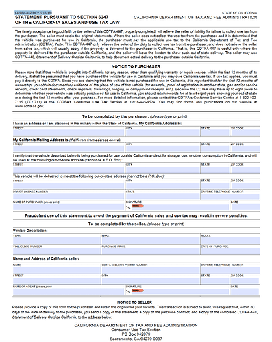

You likely wonât have to pay registration or CA sales tax, just get an exemption and one way trip permit (unless shipping) in advance if you will drive it.

If you get a tax clearance and registration permit as an out of state purchaser from the State of California CDTFA and DMV how would âfraudâ and the dealer have anything to do with it? The out of state purchaser will have to pay sales tax and register the car in their home state and would show proof of that to the home state to avoid any issues and be able to register the car in the new state with the exemption in the first place.

These exemptions deal with use tax, not sales tax. If you buy a new car in California from a dealer and drive it off the lot, the dealer is required to charge you sales tax, and will do so.
Right, because you canât do any of it online or via phone? All he really needs is the VIN, the selling dealer info and date of transport.
You can get a trip permit in CA (as you said) going to Oregon and WA per §4003 and likely do it online through the CA DMV Virtual Field Office service. Oregon will honor the CA permit and he can get one online with WA or at his closest field office. That is not three trips.
âSalesâ and âUseâ tax for vehicles are terms that are generally used interchangeably by the CA DMV and CDTFA. One is for dealers (sales) and one is for non-dealers (use). Additionally, an out of state purchase made by a CA resident has to pay DMV the âuseâ tax upon registration (which is your county/sales tax rate). Ask me how I know this.
OP - just get it delivered to you in WA or meet the carrier in Oregon if the deal is that good to offset the shipping - as the dealer suggested. If not, call CDTFA to see if you can get an exemption as the form below shows - even if from a dealer.
