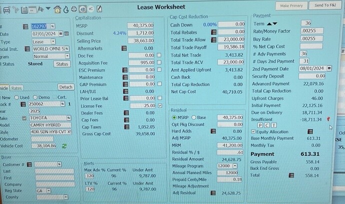

Can someone review this lease deal and let me know if there is any funny business? It doesnt seem to make sense to me. I calculate that 8k or so is going out the window to charges on this one pay upfront lease. Its georgia.

Ive loved my toyota leases this far as i usually walk away with equity each time, and the cost of ownership rolling 3 year leases is palatable for me. But on this deal im specifically trying to figure out the breakdown of the roughly 8k outside the depreciation payment. Im prepaying the lease up front, there is a grand or so in tax, there is 25 license fee, there is 995 acquisition fee. Where is the other 6k going? Towards what?
The money factor that is over 200?
Not to mention this deal has quite a bit of meat on the bone. Selling price should be BELOW Vehicle cost not above it.

Not true. No funny business. Here’s what’s happening…
MSRP 40375.00
Sell Price 38663.00 … discount is very weak at best
Acq Fee 995.00
Gross Cap 39685.00
CCR 0.00
Capped Tax 1052.05 … (see calculation below)
Net Cap 40710.05
Res. Value 24628.75
Term 36
MF .00255 … (about 6.12%… YIKES!)
Sales Tax Rate 7.00%
Base Payment = .00255 x (38663.00+24628.75) + (38663.00 - 24628.75)/36
= 613.31
One Pay = 36 x 613.31
= 22079.16
Lease Inception Fees
One Pay 22079.16
Title/License 46.00 … non-taxable
TOTAL 22125.86
Trade Credit 3413.82 … Non-taxable
DAS 18711.34
GA TAVT (Tax) is computed as follows…
Sales Tax Rate x [(S – R) + M + X]
S = Sell Price = 38633.00
R = Residual Value = 24628.75
M = Taxable Capped Fees (amortized amounts) = 995.00
X = Taxable Lease Inception Fees = 0
TAVT = 7.00% x [(38633.00 - 24628.75) + 995.00]
= 1052.05
??? Let me know.

Never said or implied that it was just a mathematical question. I know better. … I don’t like the leasing terms… MF is too high for a one-pay, IMO. Also, the discount is horrible. All I did was confirm the dealer’s numbers for the OP. Don’t read too much into this.
