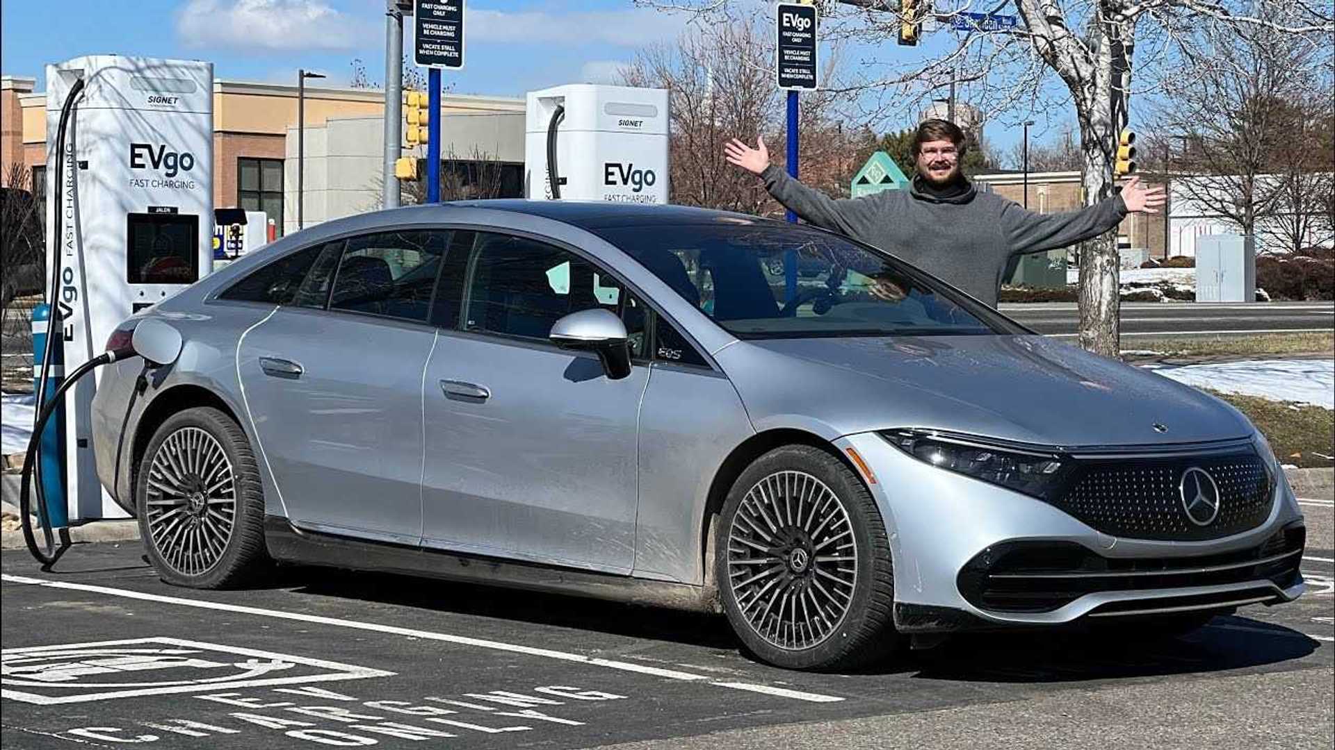

For those of you who have closed on an EQS, how has your experience been with the 2 years of free charging through EA. The only location near me maxes at 50kW but really stays around 35kW. I decided to drive out to a hyper station today and take advantage of the 350kW chargers and I’m sitting here charging at just 40kW. Do the restrict the speed of the complimentary charging? When I plugged it in, it temporarily climbed to 80kW but shortly went back down to 40kW. Am I doing something wrong? It’s kind of disheartening to know I’ll never be able to charge above 50kW.

What was your state of charge when you pull in to the charger? The EQS charging curve is about 50kW past 80%.
The EA chargers around me are hyper stations and I’ve been consistently been able to hit 190+kW. However, I only see this when my SOC is below 30-40%, consistent with the charging curve. If I plug in at higher SOCs, I see slower rates. I have seen other EVs charge at rates close to 50kW with SOCs in the 50% range, but that’s all I can say without knowing their charging curve.

I am 100% EA charging since I got my EQE in April, I do not have home or work charger. Definitely hit or miss at the 4-5 in my area buy I’ve never been totally screwed. Reach 125KWH at the 150 one this morning. The 350KWH ones are awesome.
I wish I got the numbers referenced in the article. I started my charge today at 13% and now I’m at 68%. I called EA and the rep confirmed that this location hasn’t been above 100kW in weeks. I’ll continue to try different locations and see if I can find one that works but so far I’ve been to three different charging stations (including this 350kW hyper station) and have not gotten over 80kW at any point. Just being over 50kW has been temporary.
Yeah I wish I could experience that. I’m at a 350mW now and I’ve been between 40-44kW for almost an hour and a half.
EA is certainly a disaster. Many a times the charging speed is low even when the car can support higher charging speed between 10 to 80% SOC.

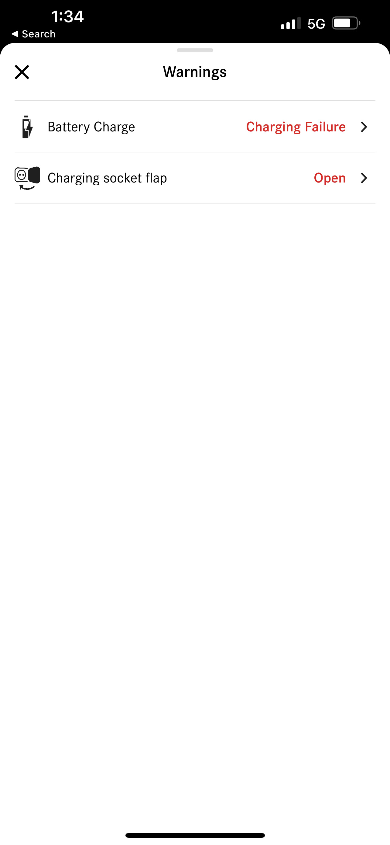

At least you guys can charge at all. I’ve been getting charging faults for the last month on all level 2 chargers.
Into the shop on Wednesday to see what the problem is.

Was your battery in a low state of charge and preconditioned? In order to see 200+kw you need to precondition, have below 20% battery, and use a 350kw charger. If you only see ~35kw, this means the cable cooling isn’t working so the charger limits output to 100 amps. You will need to set charger as a destination in navigation in order for the car to condition the battery.
