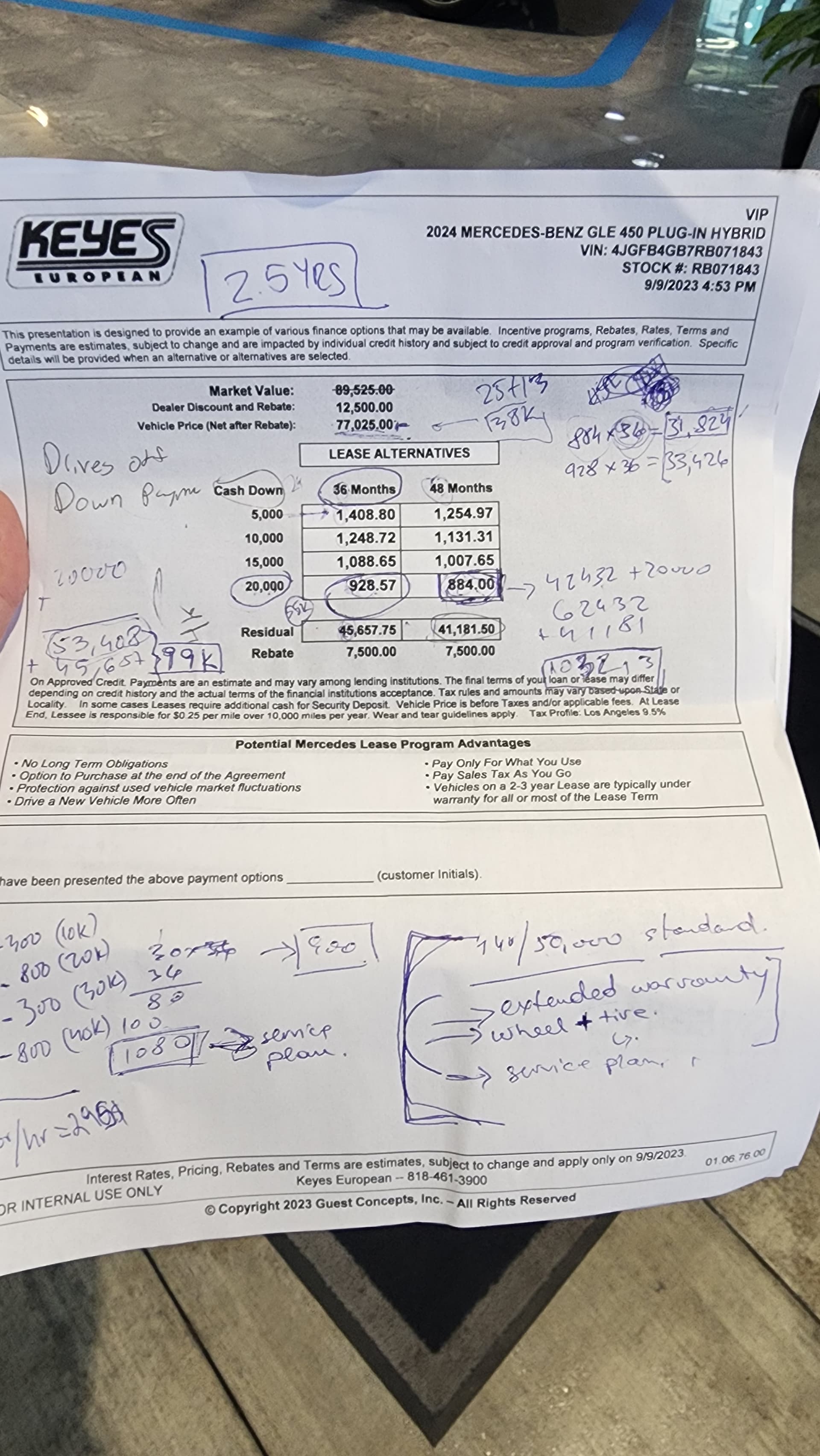

I ran the calculator but some fields confused me a bit and it didnt turn out like thr photo… i know i am doing something wrong, as i dont have a detailed breakdown.

I just got back from the dealership and i put a hold on the vehicle, which arrives in about two weeks…
I negotiated the discount to 84k (1k below invoice), and got the A9 rate, which saved an additional 1k split up over life of lease, along with that 7500.
Now… i have two weeks to determine whether a 36 or 48 month loan is better in the long run, ss i plan to keep the car. As you can see below, the lowest payment i could get is 884, with total of 20 down to cover otd costs and downpayment.
From a monthly perspective, i am okay with that payment, but in the long run, i am concerned with the overall buyout process.
Or you can just finance it now. $85k out the door. Finance $65k, 60 months at 5.5% through a credit union, $9500 in interest, total of payment and cash down = $94.5k.
Can I just say that if you can afford to put $20k down and are buying a Mercedes GLE instead of a Kia Sorrento or Telluride, you can afford $1260/mo on a loan vs $928/mo on a lease. If you can’t shell out that extra $300/mo without so much as an eyelash batting, you shouldn’t be buying this car.
