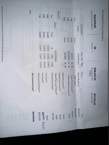

I do have some numbers for the one-pay lease though I’m not sure why the taxes and other numbers aren’t adding up for me the way they appear on the offer sheet.
These are the numbers on the offer sheet (FYI my state + county tax = 8% , likely similar to yours given you’re probably in the same county - pretty cool you live so close btw)
Non-capitalized Taxes = 2,947.66 (2118.62 State + 829.04 County)
MSRP + DPH = 66,320
Selling price = 65,820
MF = .00219
Residual = 59%
Lease incentive + adtnl rebates = 8500
Trade in = 8500
Doc Fee = 250
Registration + TitleFee = 105
Acq Fee = 795
Alternative Fuel Fee = 150
Plate Temp Tag = 20
Convenience Fee = 50
Total Fees = 1370
Total 1-Pay amount per contract = 21,532.40
My calculations:
RV = 66320 * .59 = 39128.8
Adj Cap cost = 65820 + 1370 - 8500 - 8500 = 50190
Monthly depreciation = (50190 - 39128.8) / 36 = 307.26
Rent charge = (50190 + 39128) * .00219 = 195.6
Total taxes = (36502.86 + 8500).08 = 2128.23
Total 1-pay amount = 502.86*36 + 2128.23 = 20231.19
Where am I going wrong in my calculations?
I’m in Lorain County. You’re probably in Cuyahoga. Anyway, I need to see the dealer worksheet before I proceed.
EDIT: Unless I’m missing something, their tax calculation of 2947.66 is way off based on your post. Yours is much closer but should be lower. Your 1370 capped fees include non-taxable fees like Reg. & Title, plate temp tag. I think alternative fuel fee of 150 is non-taxable. Not sure about the convenience fee (whatever the hell that is) is taxable. You need some clarity on the taxability of those fees and separate taxables from non-taxables. That’s why we calculate a base payment in Ohio. In your case, it should be lower than the 502.86. I got 494.62 because you must exclude non-taxable capped fees. If this is correct, then your total taxes would be…
8.00% x (494.62 x 36 + 8500) = 2104.51
Here is what I was provided from the dealer, I agree with you taxes seem higher than they should be.
(trade in is 8500, ignore the cross out)
Dealer taxes are way off. This is why it’s foolish to try to replicate a dealer’s worksheet. Only extract useful data (e.g., license/title fees, acq fee, doc fees, etc.) that you know are accurate. You need to research sell price for your market by checking LH marketplace, Edmunds, Truecar, etc. Vet the MF and rebates/incentives by going to Edmunds and requesting the info…
