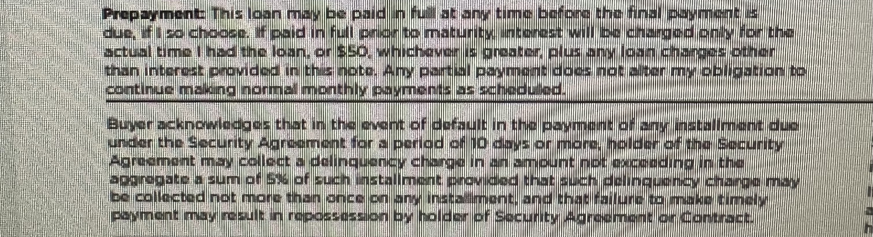

I went through all of the attachments and do not see anything about agreeing to not buyout early or after 6 months etc.
I do see the below verbiage in the purchase order and do not fully understand any negative implications to my early buyout plan
I assume that what you’ve posted is more about financing, not about an early buyout.

I was asking about the pre-payment verbiage and if there was anything there to be concerned with
