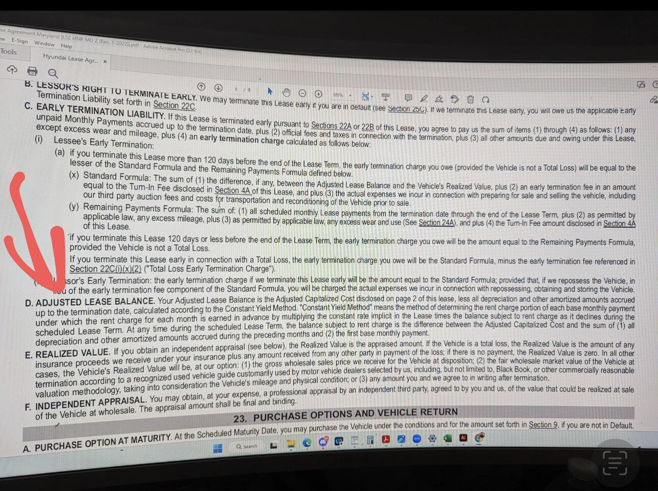

I’m trying to lease EV6 with $7500 tax credit, then exercise early buyout after the first payment. This is my first time getting my own car, and of course first time leasing.
I have read this reddit post, and trying to understand small bits. Is there anything in the contract that I would need to pay a close attention to see if I will be responsible for any unearned rent charges when early buyout? Can Kia’s lease contract differ between dealerships, so the advices from the reddit post may not apply in terms of early buyout?

  • No rent charges on the buyout. It’s in the contract.
  • The contract doesn’t vary between dealerships. Like I said in the post, some states do require a dealer for you to do a buyout.
The biggest thing to keep an eye on is that your buyout paperwork itemizes the taxes paid

I’m planning to head off to the dealership, and sign the contract there. I actually was reading those contract sections you posted, asking chatgpt to give me simpler explanation… It was very difficult for me to understand what it exactly means.
I’m just trying to make sure that I’ll be able to exercise early buyout without paying for the remaining rent charges. So if there was any chance that this dealership would give me a different contract or updated clauses, I would want to understand them on the scene.
