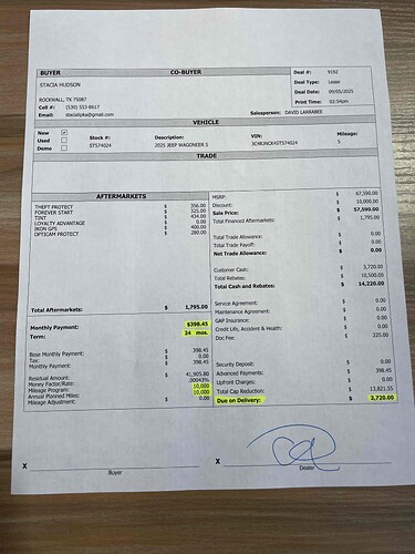

Jeep Wagoneer S - Help?
Can someone tell me the score on this one?
I made a spreadsheet but it isn’t working
UPDATED HERE, still not great but getting better

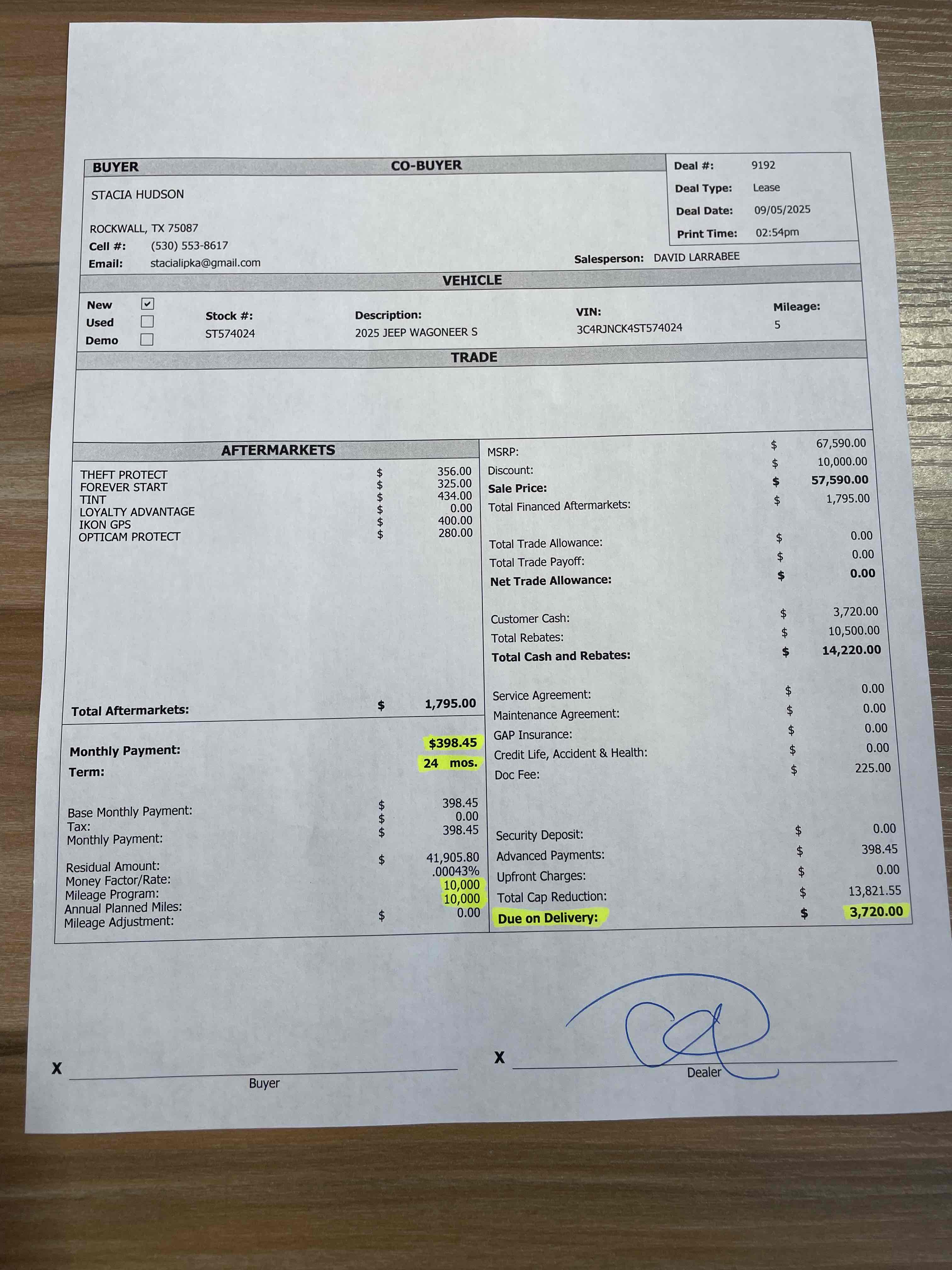

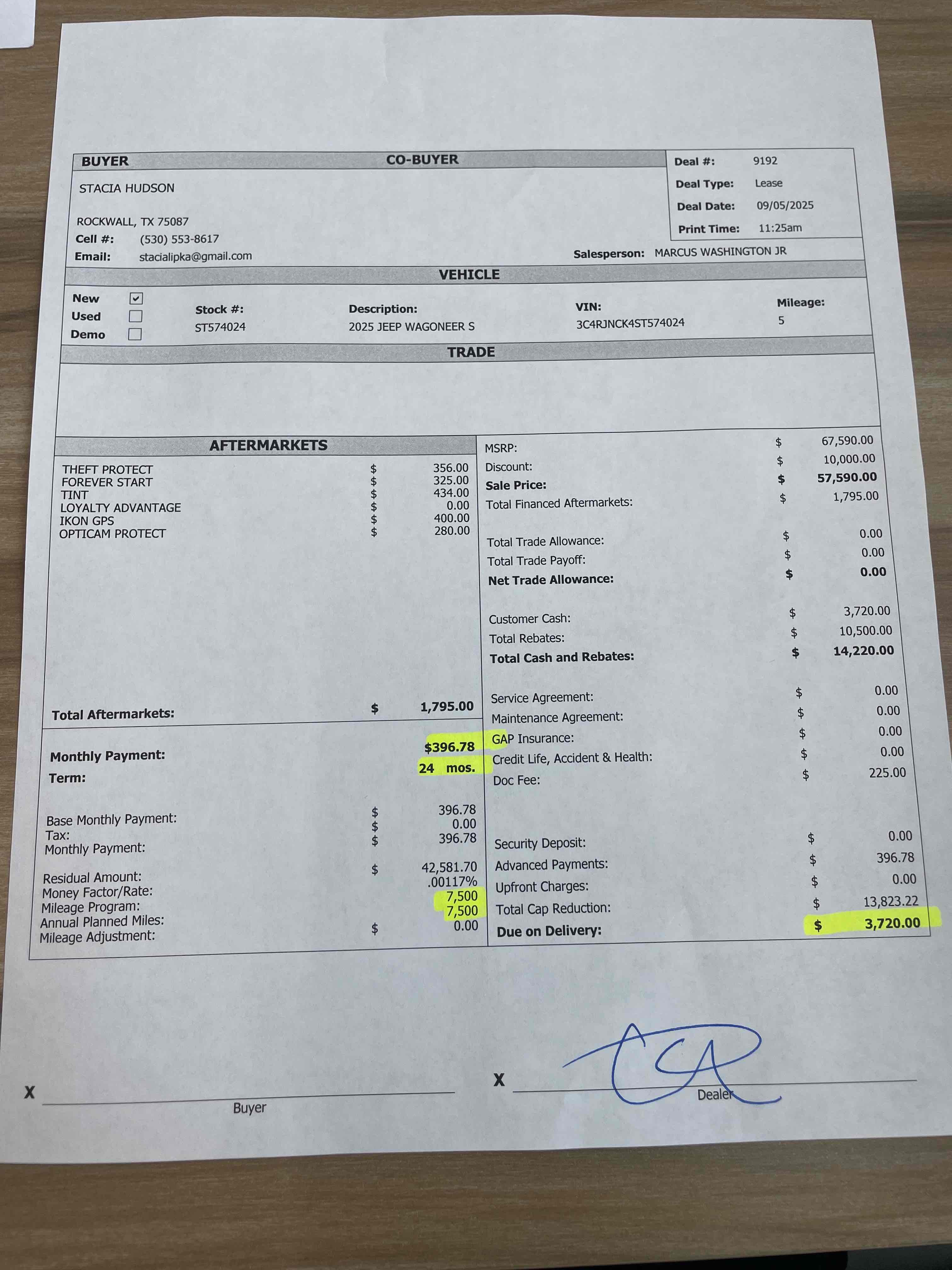

The money factor looks a little too high. It should be 0.00038. That should bring the payment down. Also negotiable on the $1,700 in accessories.
Is the $3,720 DAS the TX sales tax? I don’t see it listed anywhere.
MF is marked up significantly looks like.
0.00117 is not a percentage it translates to something like 3% and should be around 0.3%

yes and the first months payment and dealer acquisition fee.

they only accounted for $3000 + $7500 in the quote.
Ask for base MF, find extra 2k in incentives and ask the dealer to call the SFS and ask about tax credit exception for this vehicle. Sometimes banks can approve it even if they don’t have active promotion, at least some members here were able to successfully navigate such requests in TX.

I am trying to get that removed currently and got them to keep the payment the same but come up to $10000 miles.

I tried that and I got a better version back!
How does this look???
$24 a month less terrible.
