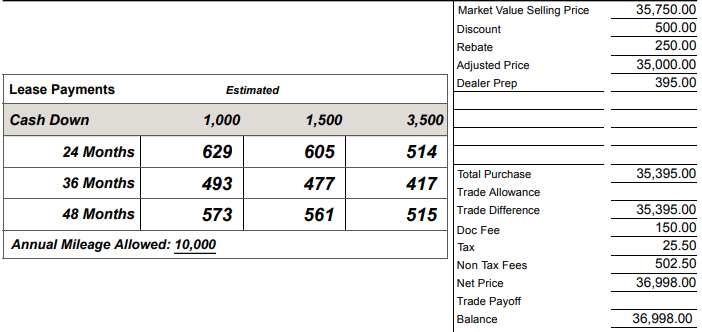

What the heck is dealer prep? The manufacture already pays them to prep the car. Where is this $493 number coming from, I doubt a dealer would quote a payment without the acq fee built in or collected. Also, do you know for a fact that they are using the buy rate for the MF? Get a break down from the dealer, screenshot or printout.
It’s a bulls**t fee basically - they wanted to charge me $990 for dealer prep + some sort of surface protection, but I called around to the dealers I’m willing to drive to and found that they all charge it. The cheapest one is $395, so I made the one I’m talking to match it.
I asked about the acquisition fee, and the salesperson said it’s not included. He could be mistaken. He also confirmed with me in writing that he’s using the same MF and RV. Here’s a screenshot of the quote he sent:
Would the acquisition fee typically be called out on a different line in the quote?

It’s already built into those payments, or it should be. This isn’t a true breakdown, it’s just a fancy 4 square. I’d ask for a complete breakdown. They have you by the balls, so you better triple check everything.

Will do - yup something doesn’t add up.

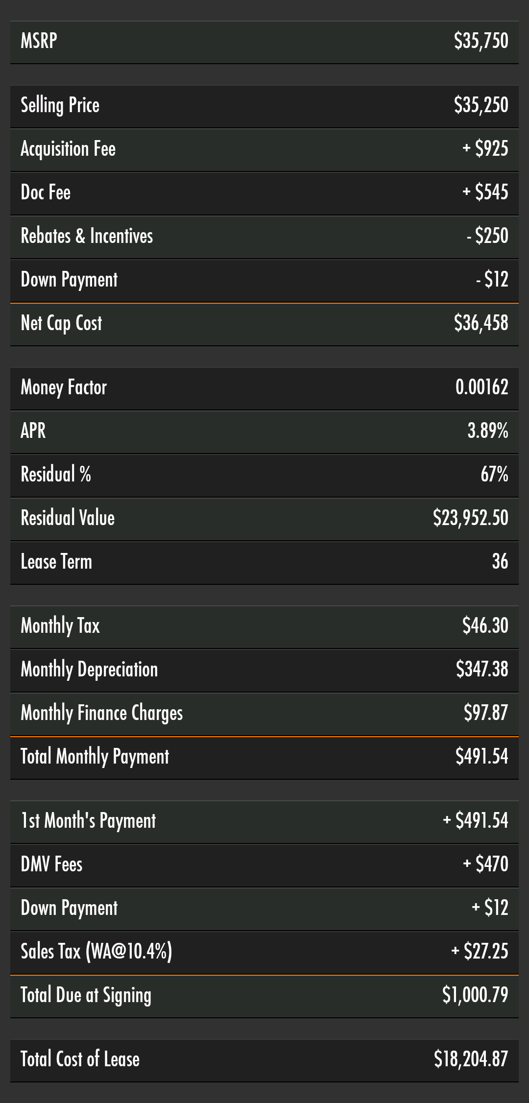

So here’s what it looks like, zero drive off $522. Take their $1000 DAS and it brings it to $495, pretty close. That’s with all their
$1000/36=$27 $508-$27=$495
Typical Seattle…no motivation to negotiate.
By DAS you mean the $1000 cash down?
Nope, Due at signing. I included the acq prep etc
The monthly comes out lower for a fully spec’d 230i than the sheet you’re showing for your mini.
Gotcha, that makes sense - I see where you added the dealer prep to the doc fees.
So their quote definitely includes the acquisition fee from the looks of it. I’ll double check with the dealer to confirm. Thanks!
