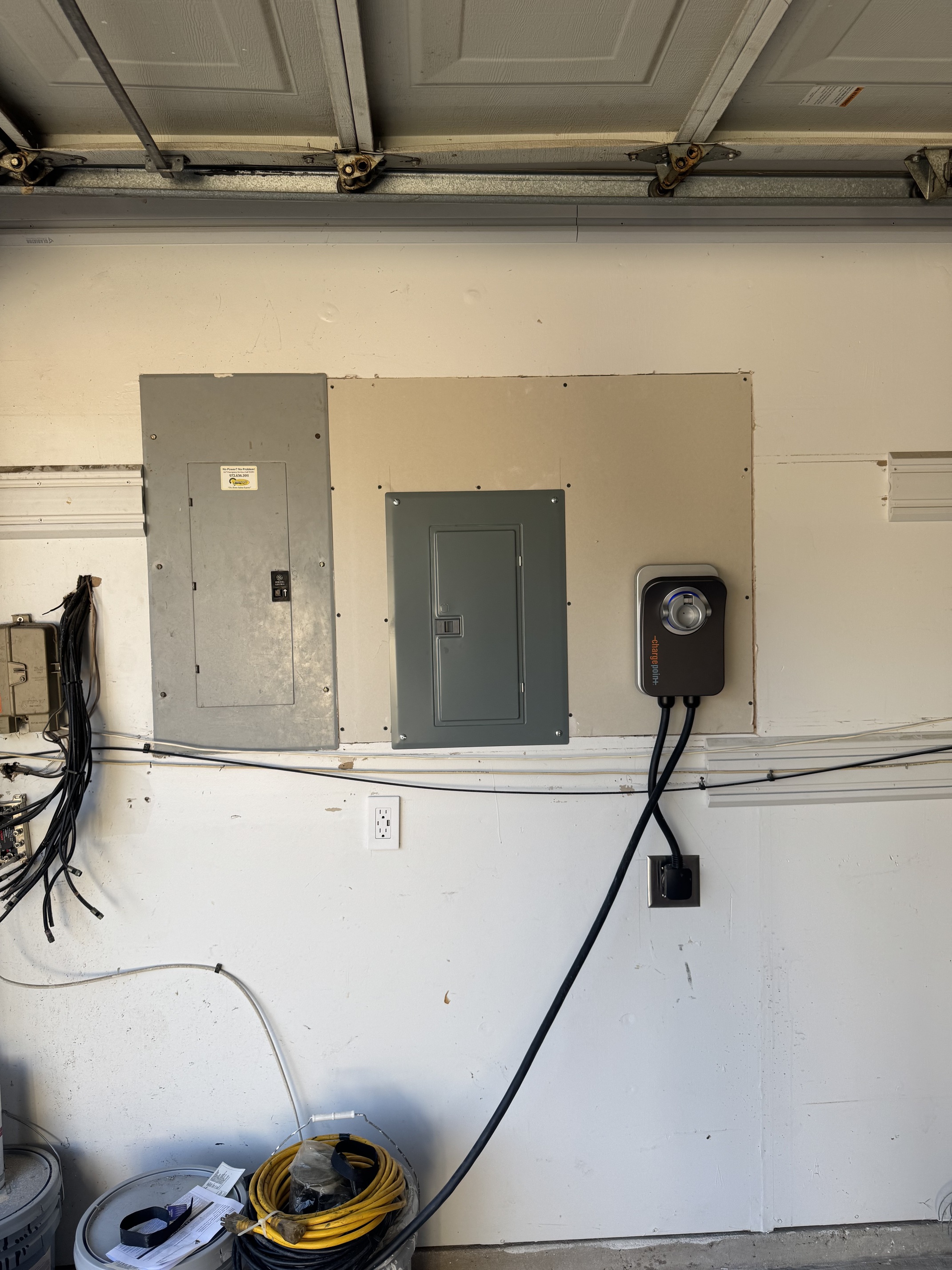

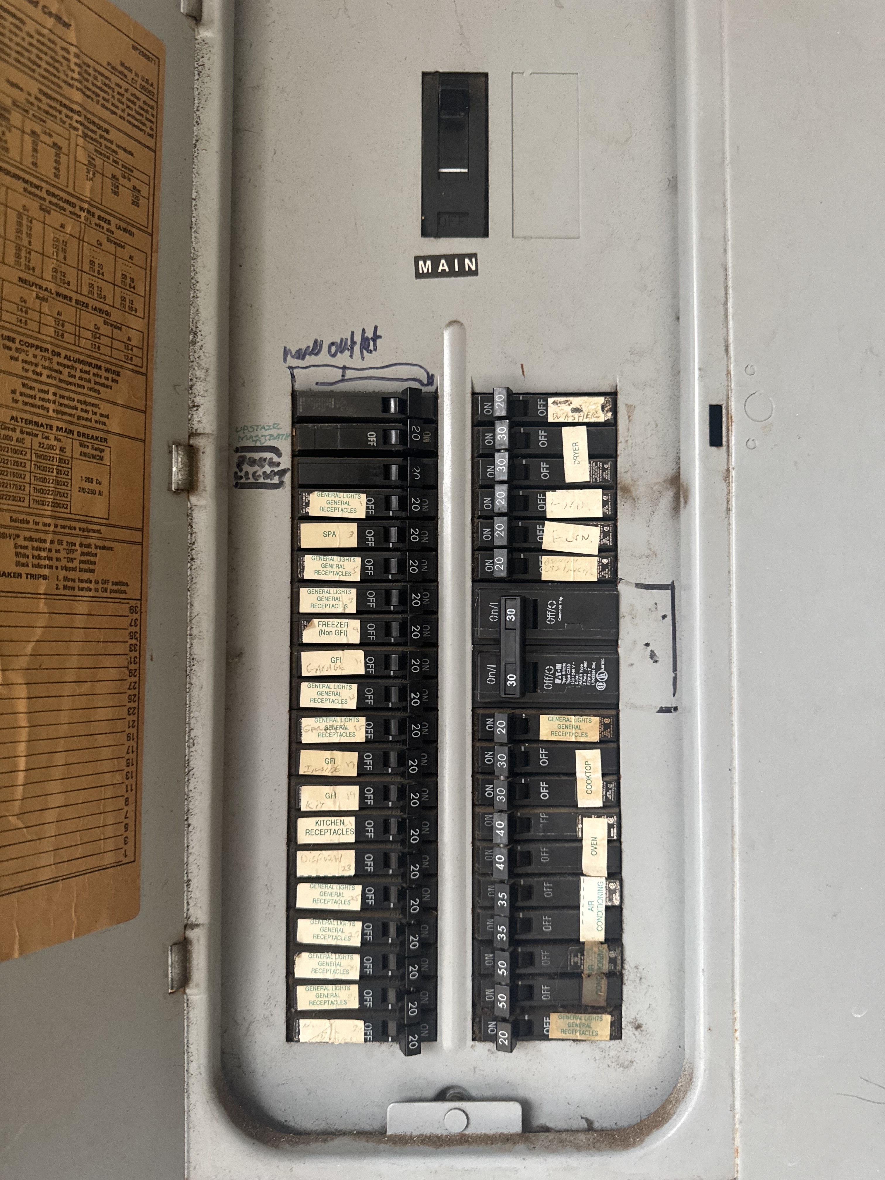

Well my fuse box wasn’t enough for new lvl 2 charger as all its breaker spots were already used, 200amp 40 breakers, so have to get additional fuse box for 100 amp to put in my 50amp breaker

You have so many breakers.

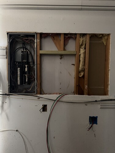

So they removed a 30amp breaker that was taking 4 regular breaker spots and putting a 100amp breaker in then creating a new fuse box for me and then putting a 50amp breaker in it for my chargepoint wall charger and putting the old 30amp in there as well, should also have lots of room for new breaker if needed.
Thank god im not the only one here doing major upgrades. This guy here is ripping his house apart :smile:

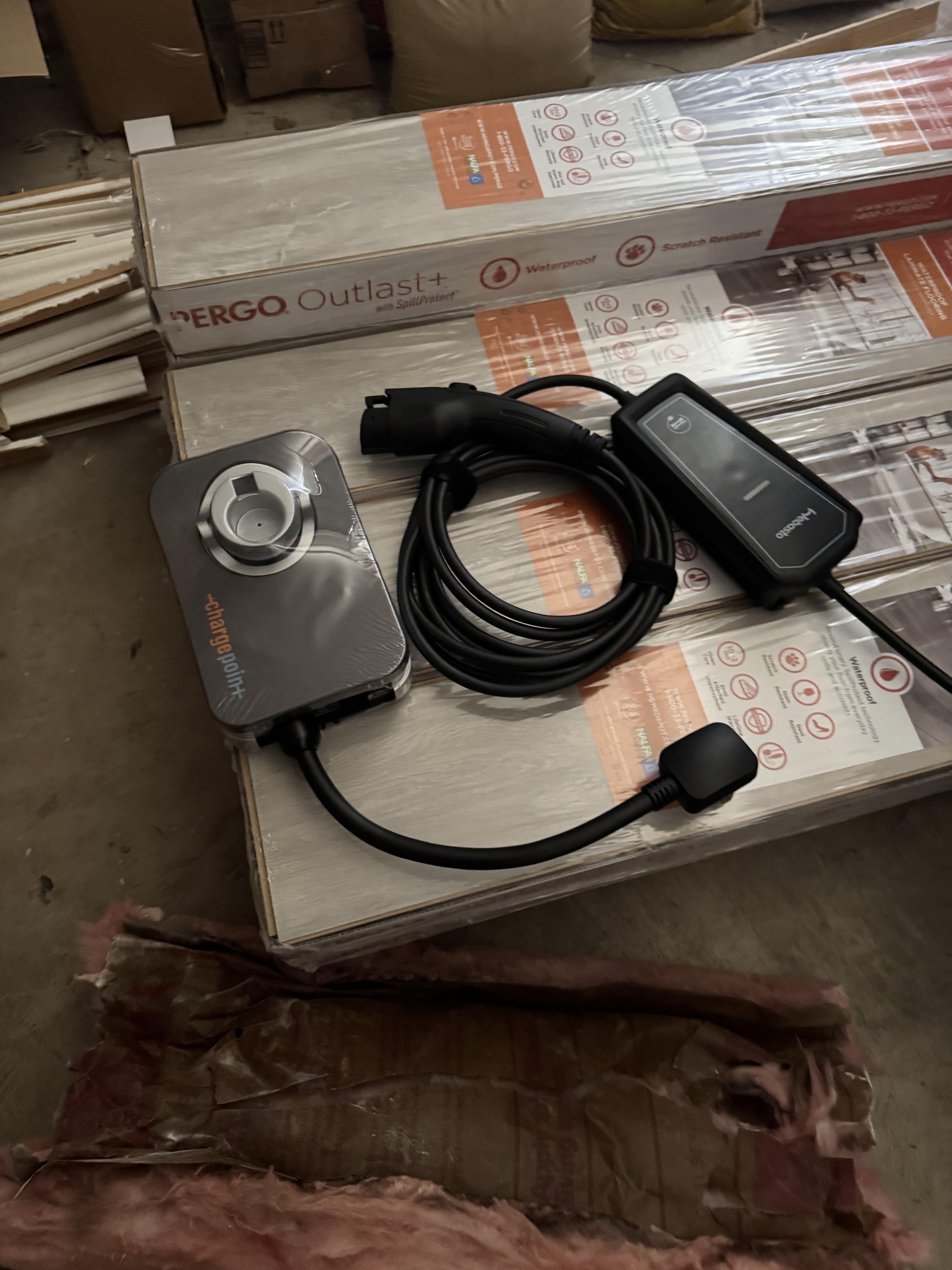

Ask your electrician to hardwired your Chargepoint vs doing NEMA plug

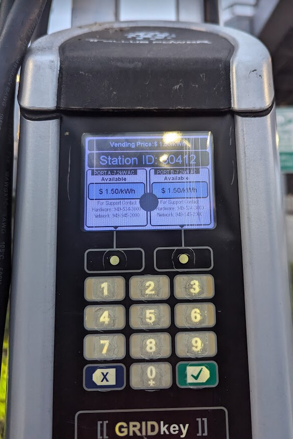

Forgot to mention this, was at an EVGateway 7.2Kwh charger at the Anaheim train station and look at the rates they are charging for slow charging, $1.50 per KWh Plus 25c Access fee. And here I was thinking EA’s 56c per KWh was bad
All my slots were full too, but I got 3 electrical quotes that all say to convert some of the singles to tandems to free up two slots for a 240v

I decided to go with plug cus this way I can upgrade the charger in the future vs having an electrician come out everytime, I know hardwired is little cheaper $550 vs $600 for plug version and it charges like 20% to 30% faster 9.9kwh vs full 12kwh but a full charge on 9.9kwh should only take 14 hours vs 12 hours so it ain’t bad. Way better then me plugging my eqs in lvl 1 on Sunday night at 14% and being told it will be full Friday night
