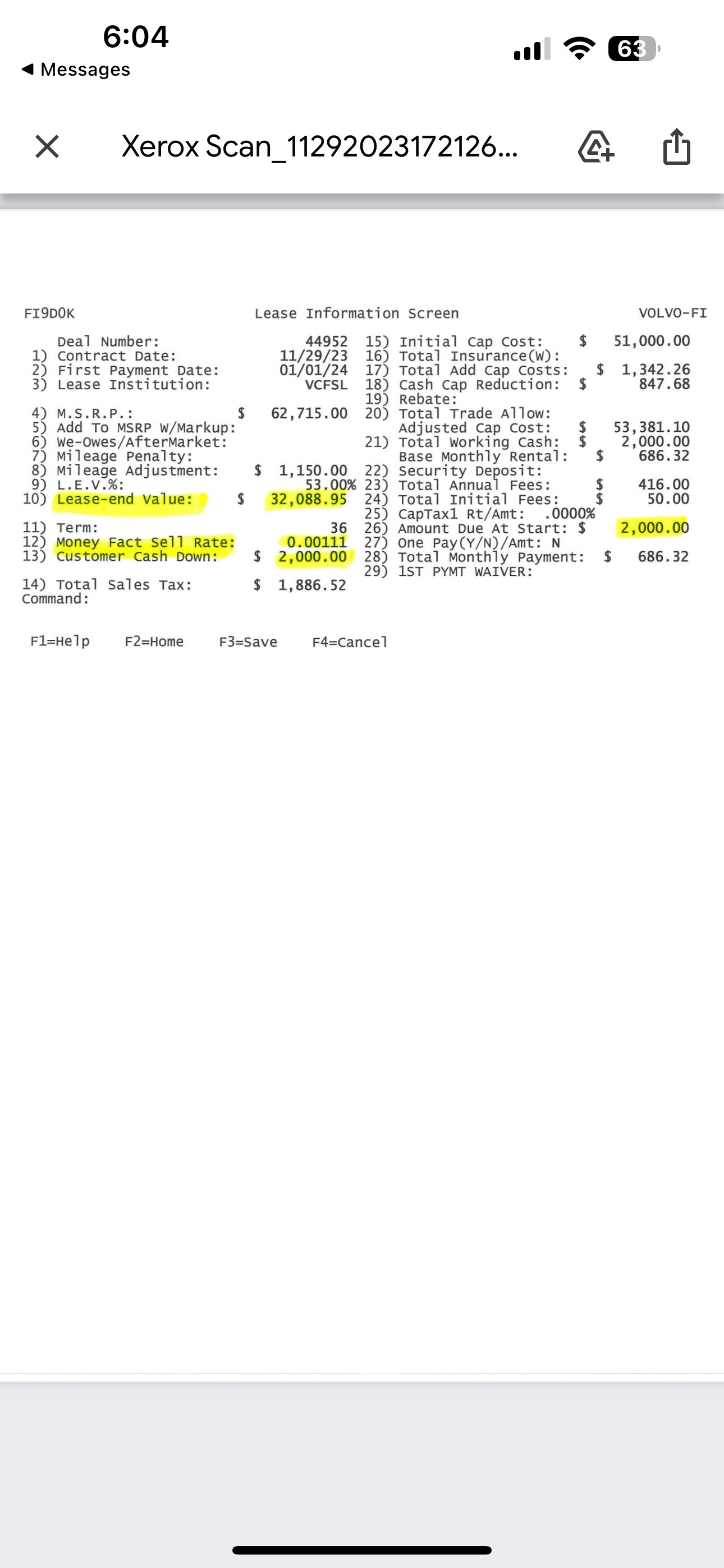

These are the initial numbers the dealer came to me with. I didn’t negotiate anything back yet. The car has been on their lot more than 200 days it said. Think they could do better on anything/where could I negotiate? I’m kind of new to this. Let me know if there’s any other information I can provide that would help in your analysis. This is located in zip code 60123 if that helps.

Ask for $350 / 2k
This car is currently in the mid $400s

Yeah I just sent him some sample deals to show what they’re really going for

Just tell him how much you want to pay and how much cash. Like $350/2k. and let HIM come back with a number
Yeah he was just like “The numbers on leasehacker and truecar might not show all the incentives and might not include tax and fees. Told him the ones most people put on leasehackr do and it’s close to what truecar lists. Then told him id do $450/2k, but he was unwilling to counter. I’ll see if another dealer would be willing to. Fortunately I’m not in any type of hurry.

You don’t mention leasehackr. You are supposed to know the numbers yourself and negotiate from there.
