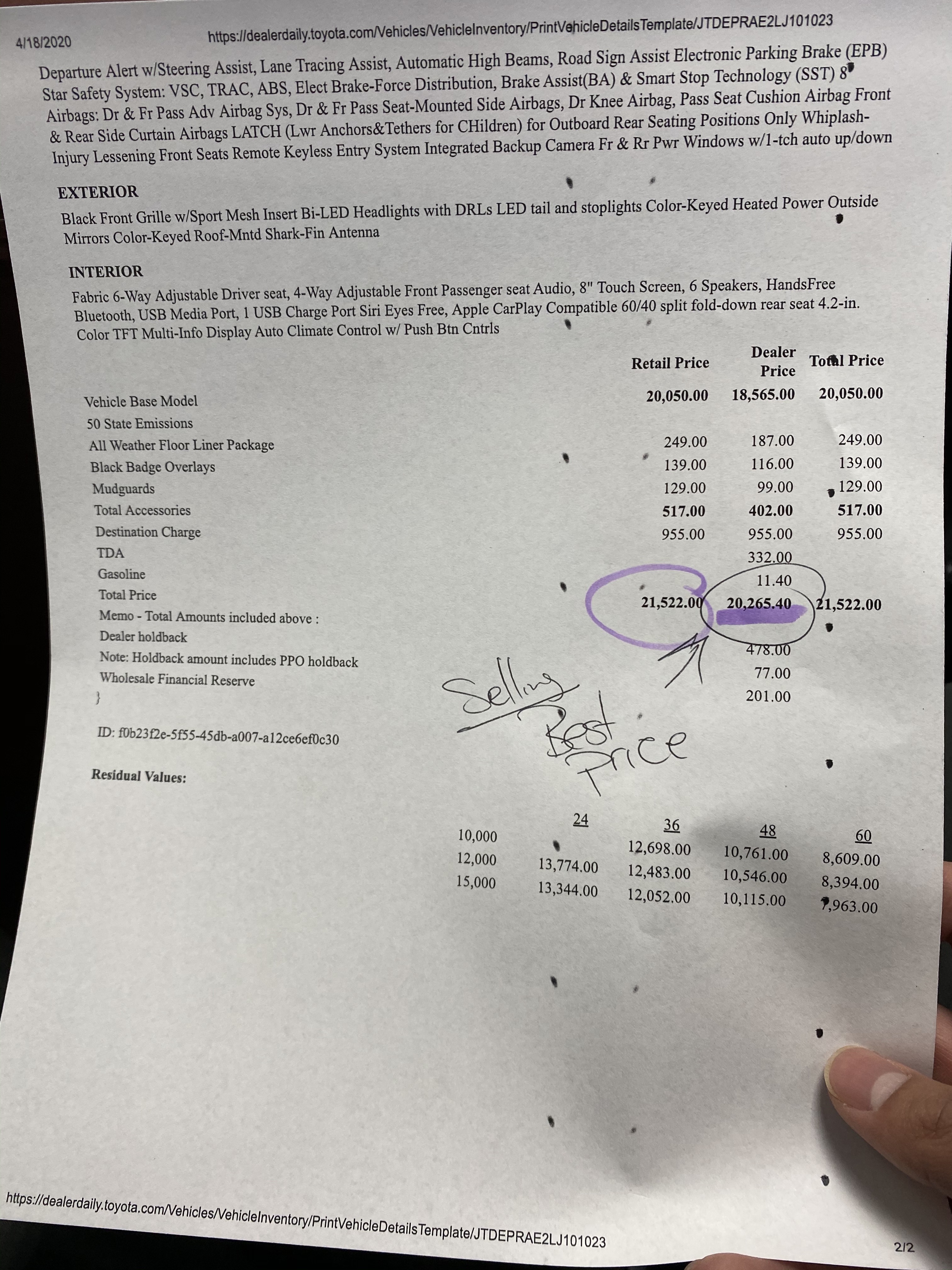

so I just got back from the Toyota dealership to renew my lease for a Toyota Corolla LE 2020. I didn’t make a purchase yet. I just wanted to evaluate the deal before signing anything. Here’s what they gave me for 12k Miles, 36months
Retail price: $21,522
Selling price: $20,265
I added the $500 graduation rebate on top of the cap cost decreasing the overall price to $19,765.
Therefore the dealer gave me $240/monthly with tax NOT levied into the monthly
OR
$255/month WITH the tax levied into the monthly payments
the dealership managed to waive the Document fees of $595 putting the amount id put down to $2,900. This includes all the fees I cant avoid such as (destination fee, license & registration, acquisition, etc), the first month payment, and the $546 total tax
[TAX IS ($240*6.6%) = 15.84/month * 36 months $570 total]
Can you please evaluate my deal and whether if this is a good deal or not. and what else i can do???

Post the lease sheet or all the relevant info please. At first glance it seems like a pretty meager discount.
Edit: I read acquisition fee sorry…doc fees vary by state and they are dealer set up to the maximum allowed by the state. For example here in MI it’s max $230 or 5% of the selling price whichever is less. Research dealer doc fees for your state. Every state is different for doc fees.
Ya I’d definitely dig for a better discount. The corolla and Toyota in general is a volume car/brand. You should be aiming for 12-15% off msrp (before incentives). You’re at 6% with what you posted without the grad incentive

I tried to negotiate the price but they actually gave me the retail/dealership price sheet. (Which I will have attached) he noted that the dealer price at $20,265 is the lowest they can go otherwise they will be at a loss.
I also brought up the Fair market price for a Toyota Corolla LE in my area shown on kellybluebook and it’s $18,122 - $20,269. Idk how else i can negotiate the price lower besides using KBB fair market price.
He showed my a binder of all the fees. Destination fee was $795. My last lease At Toyota 3 years ago was $500.
He made it seem like all those fees were fixed. I’ve also heard it’s hard to get those fees waived, reason being it’s so important trying to reduce the total cap cost of the car at low as possible.
Just stating what the guy said. Still new to this, so when the dealer says that’s the lowest they can go after showing the FMV on KBB and Truecar, idk what else to say. It came down to a yes or no after 3 hours of negotiating. But will do. Thank you.

Look to put as little down as possible. With $2900 down the deal you posted is horrible. I think you should be around the payment you posted with $0 due at signing (sign and drive).

Uhm in the picture you posted above this, it clearly states the destination fee is $955. Acquisition fee and destination fee are two different things. Destination fee is included in the MSRP. Acquisition fee is a fee charged when leasing.
As others have said, this is clearly an atrocious deal. Do all negotiation over phone and email. There is no need to go into the dealership and risk infection. I’m guessing this dealership has robbed you blind on all your previous leases.
