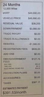

$3k dealer discount is pretty weak. Minimum $4k-$5k off for a good deal on a Blazer. $1500 is also not much in terms of incentives but if that’s all you qualify for then it is what it is.
Would recommend digging into whether or not your/your spouse’s employer qualifies for GM supplier.
Would also recommend looking into Equinox EVs if you aren’t 100% set on the Blazer EV. There is a $1,750 rebate standard on all Equinox EV LTs and no such equivalent for Blazers (unless one just came out and I’m missing that info)

Honestly this deal is pretty bad. Here is the link to my signed post for my own Blazer EV.
At the minimum that $1490 in accessories has got to go. I guess for the rest if you only qualify for $1,000 in rebates then it is what it is. But at these prices I’d go ZDX before considering Blazer

Having said that, the offer OP posted isn’t good. I recommend checking out marketplace for reference, and then shaping a deal around that.
OR wait a few more days and trying to see what are the lowest signed offers.

So the dealer took off the $1420 accessory, thanks for the suggestion. I only qualify for the GM Supplier discount. (1k discount for Blazer EV) What is considered a good/reasonable MF, as they did not disclose…thanks for any info
Why are the taxes and fees so high? I thought CA taxed the monthly payment and only rebates were taxed upfront. Not so ?
