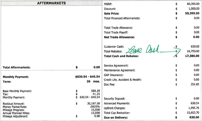

I’m confused why the deal I put into the calculator isn’t aligning with what the dealer quoted. Am I missing something, or is their doc not truthful? Thanks!
36 month - 15k miles
MSRP: $60,395
Discount: $1,000
Residual: 50%
MF: .0025
Incentives: $16,750
Calc gives me $565, they are showing me $630-640
See image for details I may have missed.
I didn’t exact it, but here you go
What you input doesn’t look much different than what I input in the calc I linked in the OP. Am I missing something explaining the gap between my calc and the image?
Your incentives are likely taxed. If you make that change, the calcs effective monthly basically lines up with the deal sheet

Ah, got it, thanks. So they need to be in taxed and then check the “zero drive off” box. That does take it more in line.

Here is what’s going on… screw the calculator. Let’s do the calcs manually and learn something…
MSRP ………………………… 60395.00
Dealer Discount………… 1000.00 (weak at best)
Sell Price………………….. 59395.00
Doc Fee………………….. 251.05
Fees………………………… 681.35 (acquisition fee, LTR?) not accounted for in WS
Gross Cap………………. 60327.40
CCR………………………… 15653.70
Adjusted Cap……………. 44673.55
RV (50% x MSRP)………. 30197.50
Term……………………….. 36
MF…………………………… .00250
Sales Tax Rate………….. 7.00%
Lease Cash…………….. 16750.00
Customer Cash………. 630.00
Total Cash/Rebates…… 17380.00
Base Payment = .00250 x (44673.55 + 30197.50) +(44673.55 - 30197.50)/ 36
= 589.29
Monthly Payment = 589.29 x 1.07
= 630.54
Lease Inception Fees
1st Payment………………………… 630.54
CCR Tax……………………………. 1095.76 = 7% x 15653.70
Customer Cash………………… 630.00
TOTAL……………………………… 2356.30
Cash Credit…………………….. 1726.30 = 17380.00 – 15653.70
DAS………………………………. 630.00
Bottom line: DAS = 630.00 followed by 35 monthly payments of 630.54 each.

Appreciate you breaking down all the numbers there for me. It was very unclear what everything is, especially the “upfront charges,” which you’ve identified as tax.

There is no way to put the total cash/rebate split between the CCR and cash credit into the LH Calc without producing misleading/inaccurate output. This is why I don’t like online calculators preferring, instead, to use my own calculator. You can learn a lot about leasing by building your own calculator which leads me to post…
