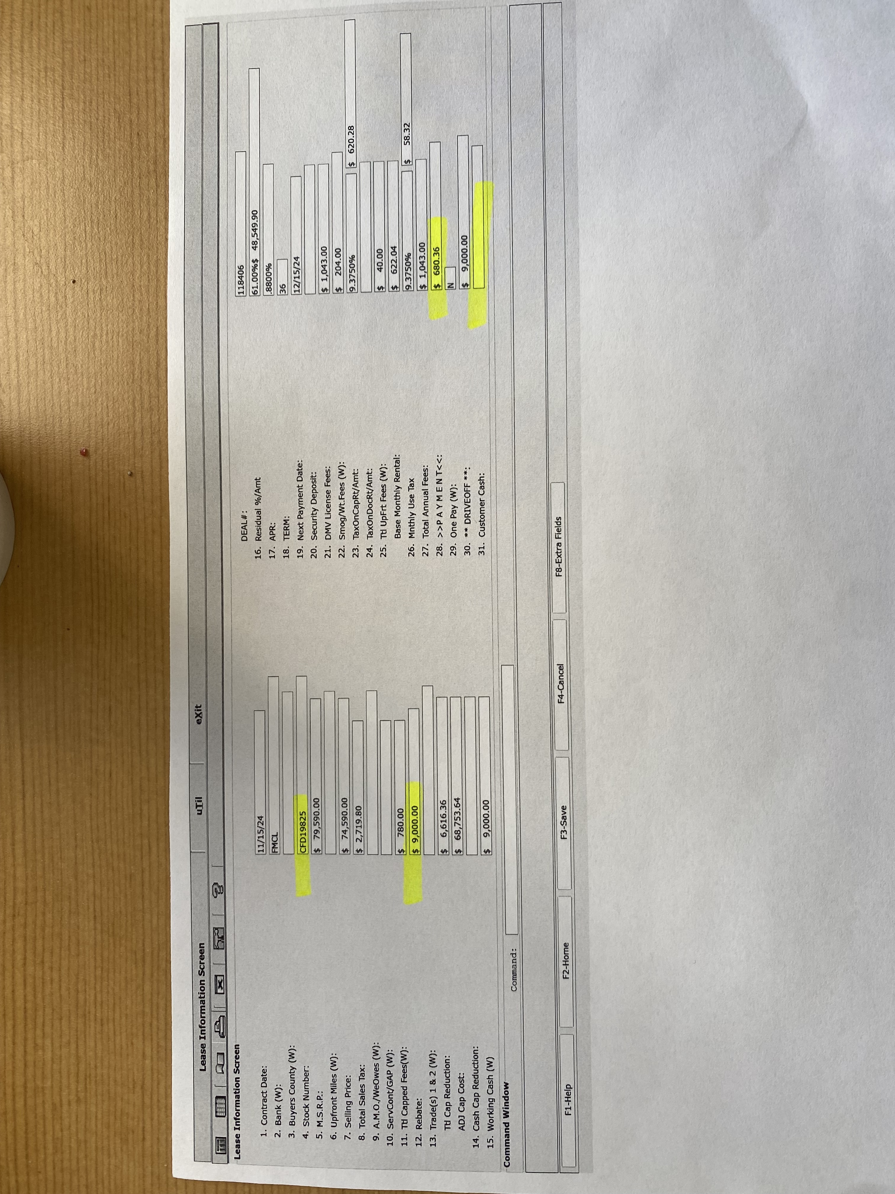

That is a killer deal. California fees and taxes will always be higher but am wondering if I can shave off another few k the sales price now. All in all doesn’t sound like it’s the best but still pretty good. Appreciate everyone’s input!
The monthly base payment of 622.04 is inaccurate. It should be 603.50. The easiest way to compute the payment is to use the Excel PMT function as follows…
Base Pay = PMT(.0088/12, 36, -68735.10, 48549.90, 1) = 603.50
Consequently, the contractual payment should be…
603.50 x 1.093750 = 660.08

The CCR is also inaccurate. It should be 6634.90 which means the adj. cap should be 68735.10.
The 9000 rebate is used to cover the CCR and the remaining amount of 2365.10 used to cover lease inception fees as follows…
1st pay 660.08
CCR Tax 622.02
DMV Fee 1043.00
Title Fee 40.00
Total 2365.10
Rebate Credit 2365.10
DAS 0.00
Bottom line: Zero drive off followed by 35 monthly payments of 660.08 each.
Thank you for that! How do I best bring this to the dealers attn

FMC uses an interest rate, not a money factor. In your case, the interest rate is 0.88%. The formula for computing the CCR is very complicated, and it’s highly likely that they’ll never understand it. To make matters worse, this formula was derived by me and exists nowhere except in my head. And, yes, it is correct. Here’s the formula…
Substituting the assigned values, CCR = 6634.90. The dealer incorrectly calculated 6616.36.
Next, determine the adj. cap cost…
Sell Price 74590.00
Capped Fee 780.00
Gross Cap 75370.00
CCR 6634.90
Adj. Cap 68735.10
RV 48549.90
Term 36
Monthly Interest Rate i .0088/12
Now compute the monthly base payment using the Excel PMT function…
Or use the formula…
Whether you use Excel or the formula, you’ll arrive at the same base payment of 603.50. However, using the dealer’s data, they’ll arrive at a base payment different than the one they calculated (622.04) in their quote…
Base Pay = PMT(.0088/12, 36, -68753.64, 48549.90, 1) = 604.02
So, they should have calculated 604.02, NOT 622.04.
Compute the contractual payment (includes sales tax)…
Payment = 603.50 x 1.09375 = 660.08
Last, construct the lease inception fees…
Lease Inception Fees
1st pay 660.08
CCR Tax 622.02 … 9.375% x 6634.90
DMV Fees 1043.00
Other Fee 40.00
TOTAL 2365.10
DAS 0.00
Observe that the 9000 rebate exactly covers the CCR (6634.90) as well as the remaining lease inception fees (2365.10) including 1st payment…
6634.90 + 2365.10 = 9000.00
Bottom line: Zero drive-off followed by 35 monthly payments of 660.08 each.

delta737h you were right – they were playing games with CCR + MF – once I got into the finance room the payment came up 1.30 more. So then I opened up the quote and realized CCR was different and the apr went 1.24. there were all sorts of humming and hawing once I started grinding them, but once I stood up to walk out, went back to .88 and, shocker, the payment got to that 660. I ended up taking the wearcare plan so out the door for 670 (500 credit with Tesla towards that) given i’ve read that Ford tries to find anything wrong at end of lease.
