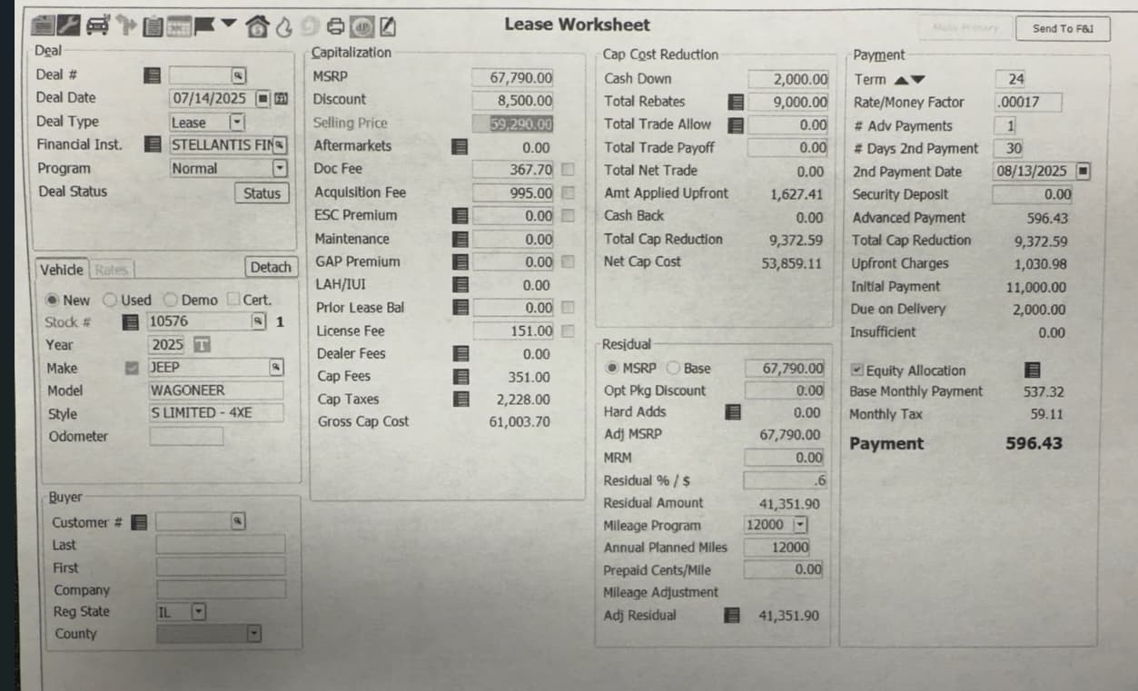

Hi all,
This seems high to me, but I am not sure where the extra amount might be.
2025 Wagoneer S Limited
24 months
12K
$2K down (includes first payment)
$596.43
I live in Chicago. So there is an extra 11% tax on all payments here.

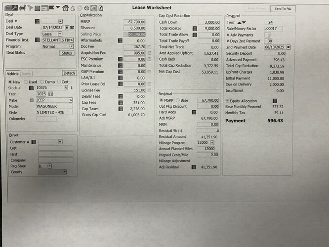

That’s because it is high. I checked all dealer calculations manually, and there are some mistakes that center around tax calculations…
In Illinois, the sum of the base payments is taxed, not the individual payments streams. So, the 59.11 monthly tax is bogus and pure BS. Also, the 537.72 base payment if inaccurate… it should be lower.
I have no idea how they arrived at capped taxes = 2228 other than to say that they are wrong which means the payments are off. The 351 capped fee likely includes the 151-license fee. I don’t know the nature of the 200 balance and so, I have no idea whether it is taxable or not. This worksheet is pure garbage. The dealer seems totally clueless. You may find the following helpful…

Nope. Do you know what the upfront charge of 1030.98 is for? It’s the tax on the 9372.59 CCR @11%…
11% x 9372.59 = 1030.98.
Also, 1030.98 + 24 x 59.11 does not equal 2228. Furthermore, it makes no sense. Again, the 59.11 monthly tax is bogus. Even if it weren’t it should not be included in the capped 2228 tax.
Your lease inception fees…
1st payment … 596.43 … which is wrong
CCR… 9372.59 … needs to be recalculated
CCR Tax… 1030.98… needs to be recalculated
TOTAL… 11000.00
Rebate Cr.. … 9000.00
DAS… 2000.00

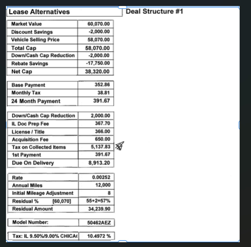

I just finished reviewing this document and, it shows on P. 22-23 that the methodology for computing tax remains the same. It’s the tax rate treatment that seems to have changed. According to this pdf, the total of the base payments is taxed, not the individual payment streams. The dealer idswrong and so is this dealer…
Isn’t the overall tax amount the same tho?
Say individual stream/base payment equal 100 on 24 month lease…10% tax is 10 for 240 total over lease…total of base payment times 24 equals 2400 times 10% is 240.
Yes, but there is a fundamental difference… tax levied on each payment as it is received is excluded from the total taxes due at signing. Taxing the sum of the base payments forces those taxes to be due at signing and is included in the total taxes due at signing. So, in the image above, the total tax of 5137.83 should exclude the monthly tax of 38.81 which is bogus anyway. There is no monthly tax levied on the base payments that the lessee would pay each month in Illinois. The monthly tax is totaled over the lease term and paid at lease inception as you described. Simply stated, your pay the payment tax all at once instead of monthly.

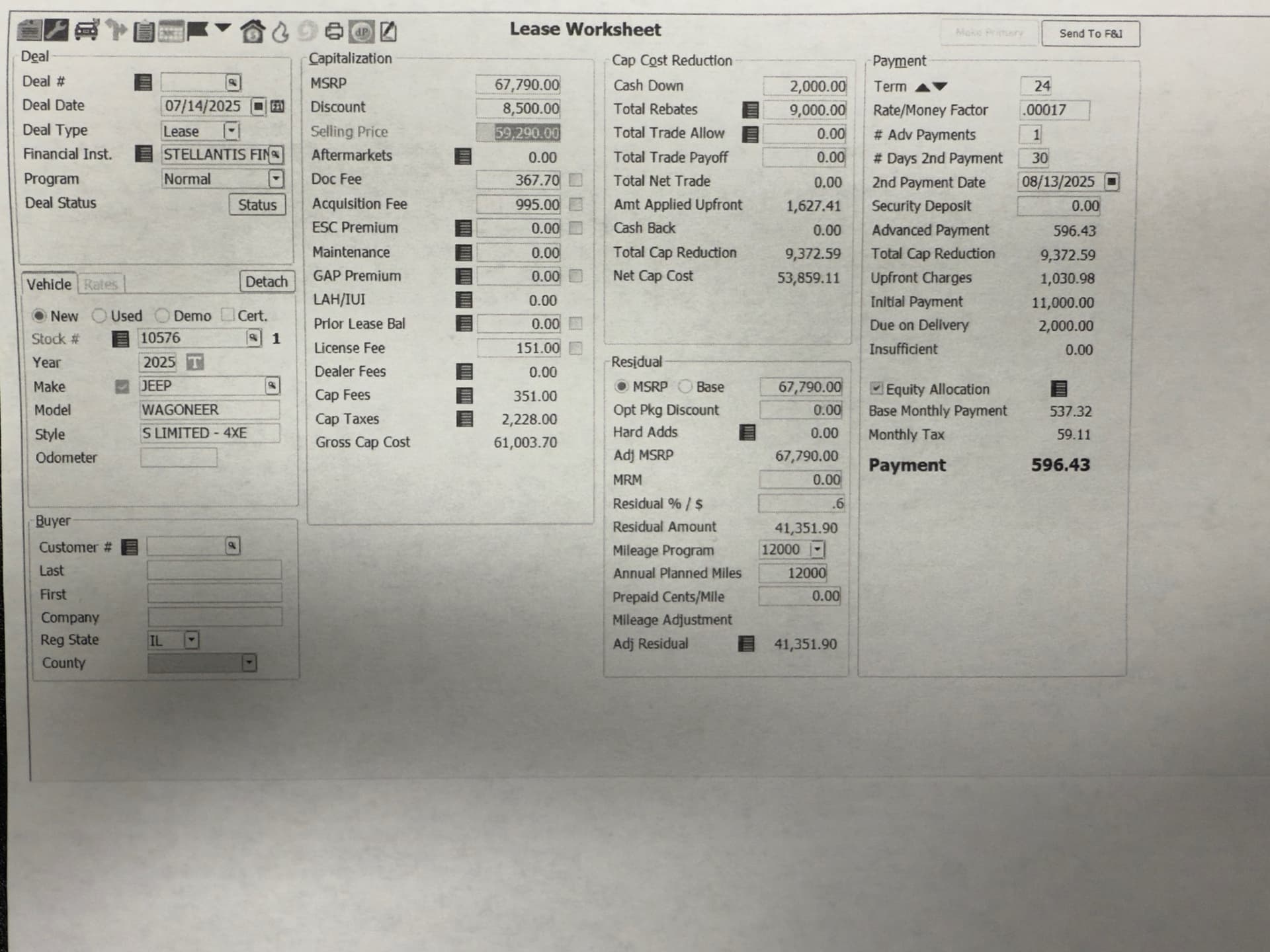

Of course they couldn’t. The last two dealer worksheets I saw, the one above and the one below, the taxes are not calculated correctly according to Illinois tax guidelines.
Both worksheets levy tax on the individual payment streams and collect the tax when each monthly payment is due. This is not accurate according to Pp. 22-23 of the tax guidelines.
