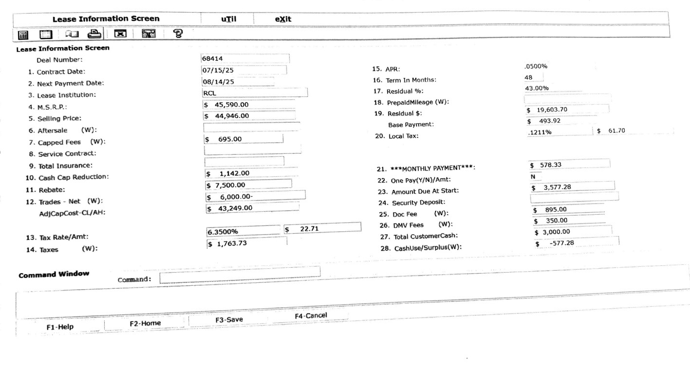

Deal check 2025 mach e premium w/neg equity (need help)
Trying to trade a 2016 impala limited ltz with around 5k of neg eq on a mache e, i qualify for the 7500 and additional state 4000 ev rebate. Ive dealt directly with the sales manager the entire time and he has ensured me he wants to earn my business. Vehicle MSRP is 45,590 , during employee pricing it was at 40,500 it seems they’ve applied 3k of the 4k state rebate as a down payment, he said this is a better deal over lower msrp because employee rate was 1.73 vs the .05 im getting now and residual was 2 points lower. Am i crazy to think this isnt really a deal or am i screwed with the equity and have no room to ask for anything ? there also valuing my trade 1k under kbb.. and i know there doing to retail it at close to 10k.
Monthly payment would be $614.20, DAS

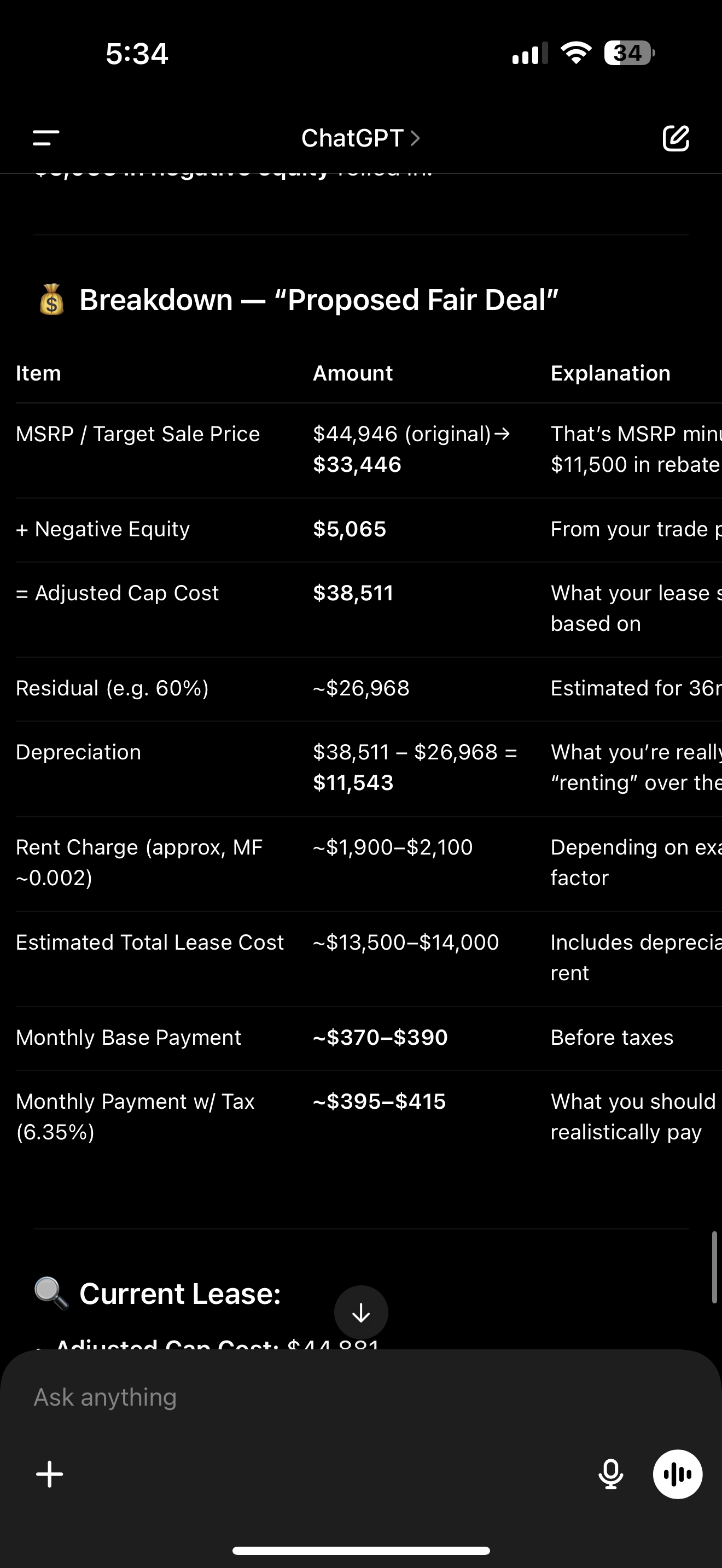

Is this how the deal should actually shake out ? Or is ChatGPT being unrealistic I had it analyze the image directly
I think it might be worth taking a step back, learning to use the LH calculator, and taking one thing at a time.
I don’t follow Ford deals very closely, but I don’t know if employee pricing would affect the RV. Even if it did, RV is non-negotiable.
You are only getting less than $700 off of MSRP pre-incentive/pre-rebate. You posted on one broker’s thread; that broker has a LH calculator w/ a Mach-e (I don’t recall if it’s the same trim) that shows a much larger discount. So that’s one thing to consider.
I don’t think that the negative equity itself means you don’t have bargaining room, but the dealer may adjust for any additional discount off MSRP by undervaluing your trade in (of which you should get additional quotes to see if the trade in value is competitive).
Is there a reason why you’re looking to lease for 48 mos? You may wish to check the RV drop from 24 mo and 36 mos vs. 48. A longer lease term dilutes the value of rebates/incentives, to a certain extent.
Also, keep in mind that you are paying $31K, just to give the car back.

So after my last post it’s clear I should target a different vehicle than the Mach E in my current situation . With everyone’s advice I’ve targeted what I believe is a hackable vehicle and maybe someone can talk me through it . 24 ACURA ZDX for my zip code 06605 seems to have the following incentives and maybe someone can confirm
2024 ZDX Captive Lease Cash $10,850
2024 ZDX Conquest Offer ($4,000)
EV Tax Credit ($7,500)
2024 ZDX Regional Captive Lease Cash ($2,300)
I would qualify for an additional 4,000 state rebate voucher that can be applied at point of sale.
That would be a total incentive of 28650 , they have 2 units msrp of 70,450 for an A-spec and 74850 for a type S
I have a trade with about 5k negative equity , my target goal payment is sub 400 for 24/12k will do 10k miles , first payment due at signing only .
iOn top of the incentives what should my target discount be on the unit to arrive here maybe someone can help with a calc sales tax is 6.35 not sure what there doc fees are
How should approach them ask them for a quote with these incentives applied and there most aggressive discount on top of that the. Hit them with the trade details ?
Can you post your best attempt at a calculator with your target deal? It should include target discount based on what you see in this forum, the MF/RV/Incentives available (and that you qualify for) based on your zip, estimated tax/dealer fees, negative equity added to the appropriate line in the calculator, and tax rate in your state.
It’s a lot easier for folks to give feedback by posting a calc, otherwise you’re asking folks to do the math for you.
