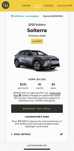

I’m not sure in MN but the Mercedes EQBs are being given away here in California.
What about Nissan Ariya or Chevy Equinox EV?
For that price you would have 2 of them.
Just look at marketplace here.
https://forum.leasehackr.com/tags/intersection/marketplace/CA-SoCal
Cross shop the Subaru isn’t it the same car. Also make sure 24 months isn’t cheaper. Either way the car is fine for 200/month but not the 470 in your quote.
