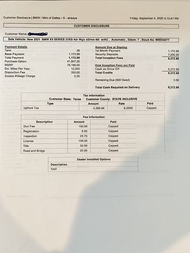

Ok, the manager provided me the worksheet - attached.

That’s a fugly deal. Plus, only the dealer marks up the MF.
Just for clarity, the dealer is doing the markup and pocketing the difference.
