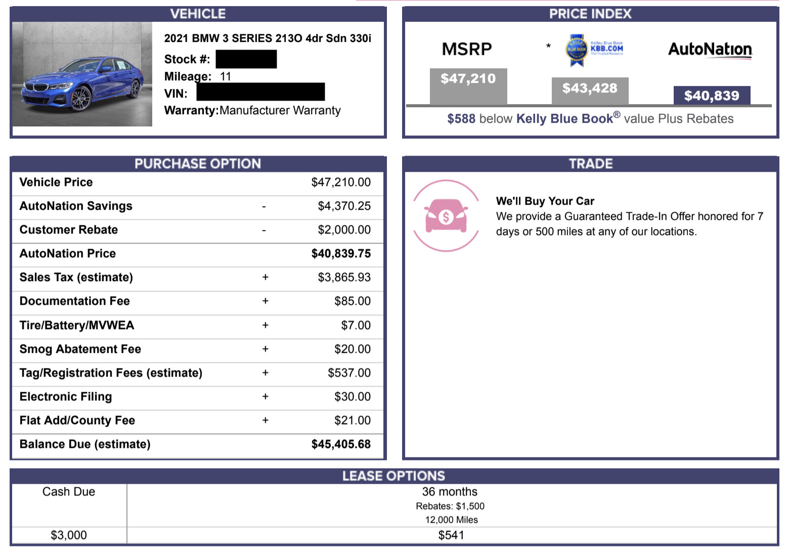

Hi all. I got this deal from the Bay Area. $3k down + $541/month (12k/36m).
The deal looks pretty shitty to me. I am confused about the difference between the customer rebate ($2000) and the $1500 rebates mentioned in the Lease Options below. I just inputted $2000 as a Taxed incentive in the calculator.
This is what the Leasehackr calculation says - Leasehackr Calculator - Hack your next lease | Leasehackr
Any tips on how to negotiate with the dealer? I did not clarify what his MF is, just calculated based on other numbers. But that 0.0027 is insanely high.

Dealer said that his MF is 0.00166
where you getting that from? 0.00093 is base, and they can mark it up as far as 0.00133 with profit, only higher if your credit is subprime. The top left box is a finance option.
The $2000 rebate is a purchase rebate, which is why it’s listed in the purchase section. The $1500 lease rebate is for leases, which is why it’s in the lease section.
You should input the $1500 into the lease calculator, not the $2000.
Also, 58% is not the correct rv for a 36/12
I calculated it from the LeaseHackr calculator. Should I ask the dealer point-blank about his MF?
No, you incorrectly filled out the calculator and then messed with the mf until you got an output that you thought matched (which wasn’t even for the same deal offered)
Yes, I went about this the wrong way. How do I go about calculating this the right way?

Based on a quick calculation, your deal is equivalent to about 5% discount with base MF.
Yeah. Here is the updated calculator - CALCULATOR | LEASEHACKR
I am thinking of shooting for 12% off MSRP (~$41500) and MF 0.00093. Not sure if the dealer will go for it.
Your calculator shows a mf of .00166. This is only possible with a bank marked up mf due to credit issues. If this is accurate, you will not get down to .00093.
Where did the .00166 number come from?
The dealer gave me this figure. How much do you think I can realistically bring it down to? My credit score is very good (~760) though.
Did you run a credit check with them? Do you have minimal lease history?
No, I didn’t. This will be my first ever car, actually.
That definitely isn’t going to help your credit situation, particularly with bmw. They’ll need to run your credit to tell you what bmwfs actually is charging, but I would not expect with a low 700 and no vehicle lease history for you to qualify for tier 1.
I see. I will see how much the dealer is willing to come down to. In the meanwhile, will see if other dealers may provide a better deal. Or just try my luck with Mercedes c300.
