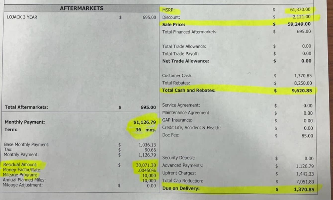

Theyre showing $747 in add ons
Adjusted cap cost + buyout fee + tax
Yes, but wouldn’t we take one payment off the adjusted cap cost shown on the sheet?
Yes, one base payment, before rent charge/monthly tax, so take another $760 off
Makes sense! Thanks again - this forum is awesome.

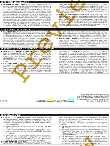

Do I need to ask the dealer of any restrictions on early lease termination / payoff? Is there any risk of this NOT working? It would be really bad to get stuck with an $1200 lease payment :slight_smile:
I wouldn’t ask them anything because what they say is meaningless and often wrong. Read the lease agreement. They are not very long and finding the “purchase option” and/or “purchase option fee” and/or “prior to end of lease term” sections takes less than a minute. Or maybe someone here can post an example from CCAP so you get can ahead of it.
See section 22B for the early purchase terms.
It’s essentially any past due payments, the adjusted lease balance defined in Sec. 19A, plus the purchase option fee of $350.
It’s exactly how I described it in my earlier post. I would assume all CA lease contracts are the same but those are the sections to look at.

What is adjusted cap cost here?
Roughly $53k. Would need to see the actual breakdown to be sure
