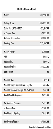

I was wondering if anyone could explain this calculator discrepancy to me. I was able to replicate what the dealer tells me using Leasematic on my phone, but not on leasehackr using all the same numbers.
Here is the leasematic sheet:

The taxes are different in both. The sales tax due upfront on the calculator is $2231 vs $2395.24 on your sheet. The $164 difference is about $5/mo.
Yup. Issue is with how the ny tax amount is being calculated. If you manually enter the taxes, it matches

I am curious: your Leasematic sheet’s sales tax is $2395.24, which means its tax base is $26988.62. How does it come to that figure?
I can’t figure out what you mean mathematically (how you tax that line item and it matches up), but I did see this in the State-by-state settings that leasematic has automatically set:
They have “Taxes capitalized tax” set, which I think is what you mean.
If anyone can explain to me how that works math wise, I’d love to know, because I don’t know how they get to that amount, even knowing that they are 'taxing capitalized tax".
Yes that’s what @max_g meant.
It seems like Leasematic assumes that the lessee is financing the tax. In that case, there are many ways to the dealer could determine the tax base. I am not sure how Leasematic calculates the tax base. Do you have the lease worksheet from the dealer?
I’ll see if I can get it, just had a basic breakdown.
Also, it doesn’t assume that. There’s a “cap sales tax” option on the settings for the deal. If you select that, you get what I shared above, if you don’t cap the tax and pay it at signing, then it shows tax at 2,199.68
Further update from the creator of Leasematic:
“This setting only applies to New York. NY is one of those states that requires tax to be paid upfront. That’s the only state that charges tax on tax if you don’t pay sales tax upfront and decide to roll it in your monthly payment.”
