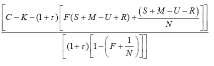

Looking at the CCR calculation. What is R? All the other variables are labeled throughout, but I couldn’t figure out what R was. I tried plugging in residual value (labeled as RV) but my lease inception fees didn’t quite add up as cleanly as yours did.
EDIT: I think I flipped a + for a - somewhere. I’m getting the expected numbers now!
Thank you for pointing that out… my bad. Yes, R is the residual value… forgot the V.

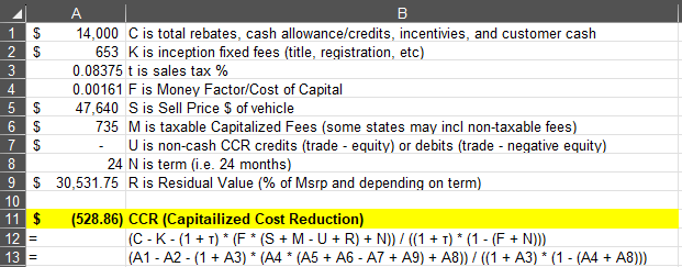

Hi @delta737h, thanks for sharing this. It is an interesting read and great refresher. I’m trying to recreate your CCR calculation in Excel (below) and my answer is a bit off. My formular might be wrong, but do you have an Excel formular template you could share?
Your formula is incorrect. Input the formula exactly the way it is written below with cells named appropriately…
