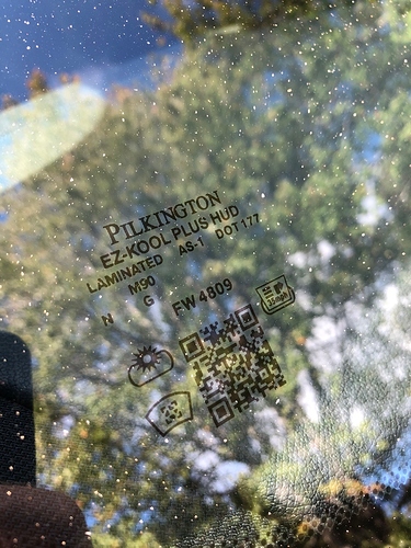

I just had a replacement windshield on my x3 with HUD display and it was an aftermarket by PILKINSON glass. everything works including HUD.
Replacement was $525 including labor compared to $3200 what bmw dealer quoted me.

My windshield says “HUD Approved” Pilkinson is O.E approved replacement

No such thing as pilkinson.
Maybe you mean pilkington?
Here’s the replacement windshield.
yea thats what i meant. thanks
Wow you got an ez kool windshield. Probably stays cooler now.

I don’t know if there is a list of approved aftermarket windshield, but this is the best company for any glass in aftermarket world.
Pilkington is oem brand for Honda windshields.
