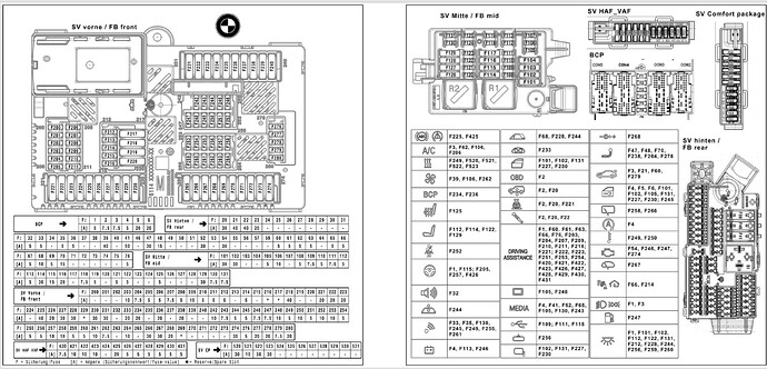

Anyone have an issue where you use the 12v socket near the cup holders and it no longer works? I used the tie air pressure kit the car came with and it randomly shut off and now the 12v doesn’t work. I feel like it got shorted? Anyway to fix?
Worth inspecting if you blew the fuse for that 12v socket.
https://www.ixforums.com/threads/fuse-box-location.1186/
Edit, maybe @z0lt3c or someone with an iX can confirm where the front fuse box is located. It may not be the box by the center console.
This is helpful, I guess better to just bring it to the dealership to look at. I was hoping it was an easy just resetting if it was tripped or something.
IMO if you bring it in for warranty work and they discover you blew the fuse with whatever you plugged into the 12v outlet, they may charge you for the labor op.
Depends on the quality of your dealer, but I’d personally find that fuse box first. Assuming you can locate the ā€œFrontā€ fuse box, take a picture of F268. Most cars have a fuse puller somewhere, not sure about BMW.
Thanks, for the advice!
Yeah I see your conundrum that in typical Deutschland Uber Alles mindset, they made the fuse box under the center console almost impossible to access.
I was thinking it was just under some plastic door, but it seems worse than that. So yeah… not really sure what’s the best way to proceed here. Maybe you can call the service desk and see if they’ll inspect the fuse out of goodwill. But get that in writing/text before you randomly show up there.
Indeed under the center console is where you’ll find F268. The diagram is kind of misleading for Americans though. The diagram is rotated to face what we would consider the passenger (starboard) side. So F268 is on the passenger side closer to the firewall.
