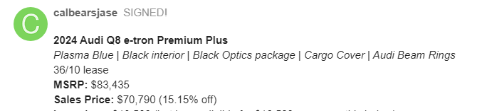

Agree, every dealer offered me something off of MSRP most just 2-3% but that is still better than nothing. I would say I spent 6 hours working my opportunity and frankly if I didn’t mind color choices I would’ve been done in 35-45 minutes at 13% off with the additional $14,800 in incentives.
