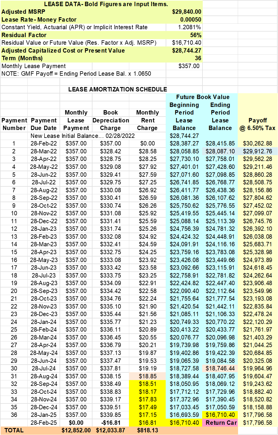

Second- If you look at the early termination provision of any lease agreement, it reverences the implicit interest rate or the lease amortization rate called the constant yield rate or actuarial rate. I have many posts that reference how to compute the CYR used to amortize the lease. This is important in determining the lease balance at any point during the term of the lease. Below is an example of a lease amortization schedule…
As you can see, the monthly rent (interest) charge and lease balance declines throughout the term of the lease. The lease balance converges to the residual value at lease end. The MF = .00050 and the CYR = 1.2081%. An estimate of the CYR is MF x 24.
So, .00050 x 24 = .01200 = 1.20000%. Some people erroneously compute the CYR = MF x 2400 which gives 1.2 = 120%. I think they know better but it’s pure slop.
