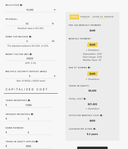

I’m a bit confused because it seems to me the payment should be more like $450 before taxes…
Post your calcuator for how you got to $450
Here’s one from Leasehackr.
Here’s the link to it
Youre missing the acquisition fee from your calculator, which isnt insignificant. Add that in and your calculator seems to line right up.

Here’s another one showing $465 base price. Does include license/doc prep.
They said that was already baked into everything. I guess I need to get a copy of what I would be signing rather than the quote sheet to see where every penny goes.
Doesnt work that way
Something to keep in mind here is going from no taxes to taxes isnt just multiply the monthly payment by 1.08 and calling it a day. You have a good thousand dollars in upfront taxes as well that have to get added in if youre quoted a pretax price.
