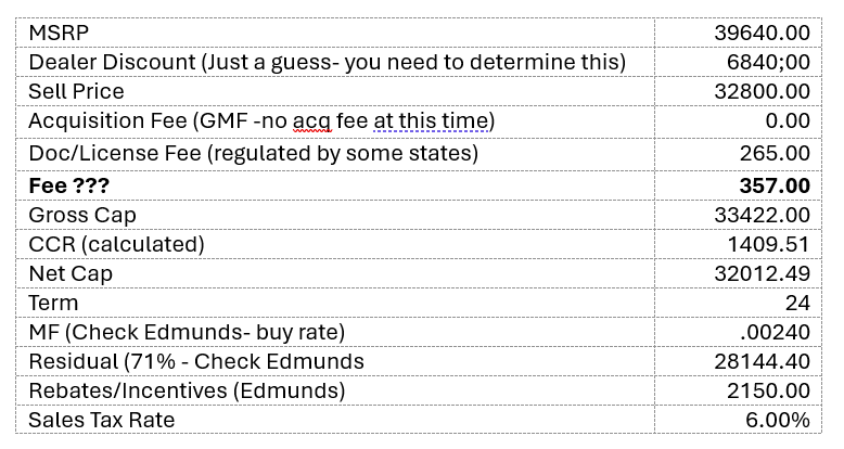

The only thing useful about dealer lease worksheets is the input data (bolded below). All data should be vetted such as acquisition fee, doc fee (regulated by some states), cost of money (e.g., money factor), gov fees, residual, rebates/incentives, sales tax rate, etc. Make sure the residual matches the term and annual mileage requirement. Check available tax credits/incentives via the fund provider who may cover taxes or, at minimum, may assess a lower sales tax rate to energize sales for some models.
Organize all relevant data in tabular format like those below with the goal of creating a lease proposal that reflects your target deal. The idea is to create your own target deal (proposal), not replicate the dealer’s deal.
The non-disclosed 357 fee makes no sense. Rebates are usually treated in one of two ways: (1) Compute how rebates will be allocated. Rebates are often used to cover lease inception fees with any remaining balance used as a CCR, or (2) Use the entire rebate as a CCR. Referencing option (1), I’ll spare you these calculations unless you would like to see how they’re done by sending me a PM.
Next, perform monthly payment calculations like those shown below.
Base Pay = .00240 x (32012.49 + 28144.40) + (32012.49 - 28144.40)/24 = 305.55
Contractual Pay = 1.06 x 305.55 = 323.88
Now, table all lease inception fees and how they are to be paid. Depending upon how the CCR is calculated (there are several different formulas), will determine the amount due at delivery (signing).
The CCR be calculated so that DAS = 0. As a side note, I would not capitalize non-taxable fees such as taxes and gov. fees. In those states the tax the individual payment streams, you’ll pay tax on capped non-taxable fees. As such, I would pay those at lease inception.
Observe that the 2150 rebate exactly covers the CCR as well as the lease inception fees including 1st payment. So, the 2150 rebate is comprised of two components: (1) the 1409.51 CCR and the 740.49 used to pay all lease inception fees. I have no idea what the 416.61 covers. I’m betting it likely includes a DMV fee and tax (84.57) on the CCR.
Bottom line: Zero drive-off fees followed by 23 monthly payments of 323.88 each.

@paranoidgarliclover posted screenshot of calc from dealer.
@mllcb42 2024 Buick Envision Preferred Demo Lease...decent deal or is the dealer holding back? - #4 by mllcb42 Thanks, I plan to figure out how to compose a target deal with solid numbers to go back to the dealers with.

Yup. Look at the first column of the second dealer’s WS “prior lease balance” … 622.
Gross Cap = 32800 + 622 = 33422
I assume that the two WS you posted are from the same dealer.

$622 (remaining lease payments) minus $265 (doc and license fee) = $357. Does this mean the dealer is charging me for part of remaining lease payments but not the doc/license fee?
Shouldn’t gross cap really be 32,800+265 = $33,065?

Then, why are they using it as a capitalized cost in their WS? That means you’re paying it. So, they told you something that just isn’t true. lied.
Looking at the WS, when I see Amount Applied Upfront = 740.49 and Total Cap Reduction = 1409.51, I’m seeing a total of 2150 which tells me it’s a rebate. Nowhere in the WS do I see 740.49 applied to reduce the lease inception fees. What I see is 1250 being applied to reduce these fees plus an additional contribution of 900 from you to reduce these inception fees. 900 + 1250 = 2150. It seems to me that you’re only getting part of the rebate (1250) instead of the entire 2150. Another way to look at it is that you’re paying 900 toward the 1409.51 CCR.
To reiterate, something is very wrong. I would definitely delete the 457 fee in my first post and question the 416.61. The 900 is a non-starter for me as I did not include it in my original post.
No, the dealer is charging you the entire 622. Look at the dealer WS. The boxes for the doc fee and license fee (first column) are checked. This means you’re paying these fees upfront and is likely included in the 416.61.
Nope. See above.
Gross cap = 332800 + 622 = 33422
Tell the dealer to keep his promise and cover the 622. I’m sure he has a lot of room as the dealer discount can likely be improved.
Lease Inception Fees…
1st pay 323.88
Upfront Charge 416.61
CCR 1409.51
TOTAL 2150.00
Rebate Credit 2150.00
Amount Due 0.00
Best to double check the rebate. Use Edmunds a few other dealers. KIt sure looks like 2150 to me.
