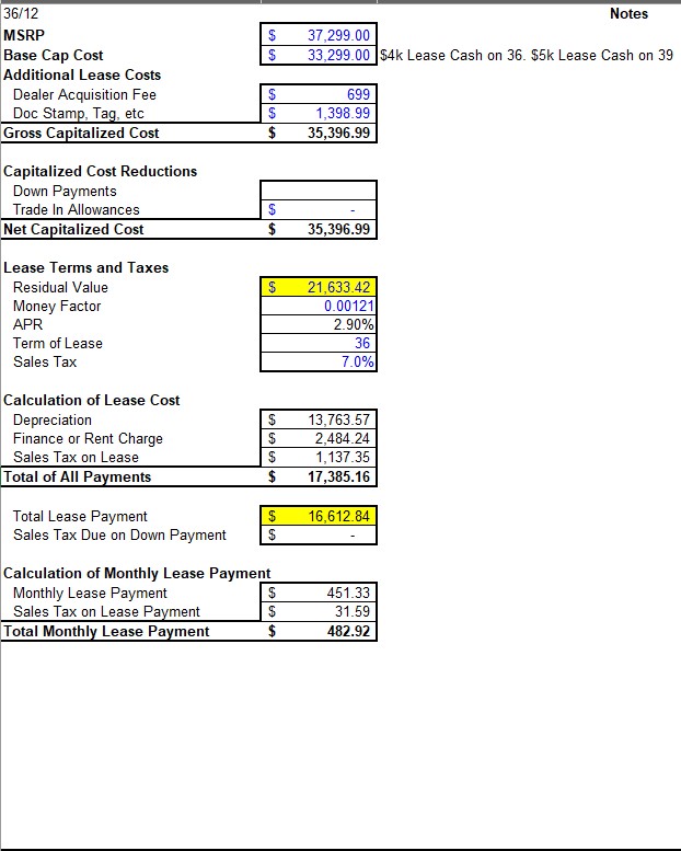

The sheet confuses me. What comprises the $1398 “stamp, tag, etc” line?
Why are taxes in there twice? First on the total of lease payments and then again per payment? What is the MF on 39 mos? Line up top states there is an additional $1k incentive for 39. Why do “total of all payments” and “total lease payment” differ?
Your numbers here do not appear to be for $0 das either.
  1. The $1398 is Doc Stamp fee in FL + DMV fees.
  2. Taxes are on there twice because it shows the total payments by Depreciation, Finance Charge and Sales Tax paid over the 36 months ($17,330.45) which when divided by 36 equals to the monthly lease payments below that ($481.40 of which $31.49 are taxes paid monthly). These numbers are also rolling in the dealer and dmv fees.
  3. MF on 39/12 is .00175 RV 56%. Came out to about $8 dollars less a month, but about $1,200 more interest over all.

Your payment is calculated as the total lease cost/36. That would be first month’s payment das. To be $0 das, your payment should be total lease cost/35.

The doc stamp line doesn’t make sense. There is no doc stamp fee on a lease in FL, that only applies to the loan amount you finance (.35% on amount financed). You will have registration, tag and some minor state mandated fees (tire & battery), a $50 a year lease charge (I think that is right) but all that should be less than $300 total.
You have a dealer fee of $699 also listed so you need to breakout and better understand that $1,399 line item as most of that looks to be additional dealer profit adders like electronic filing and coffee machine maintenance.
Edit: You have $699 dealer acq fee. I think you meant lease acq fee from the captive. So your 1,399 is mostly the dealer doc profit adder. So minus your incentive, you are paying MSRP plus the dealer is adding $1000-1200 in junk fees. So you are paying 3-4% over MSRP…
I was under the impression the Doc Stamp fee is a bullshit fee that Florida gets away with charging asinine amounts for and no dealer will negotiate that at all, on my last lease I negotiated it off the out the door price to make up for it. So the $1389 cost is that plus DMV fees.
The Deal Acquisition Fee is actual $650 not $699, according to the Lease hackr calculator.

It looks to me like a nomenclature issue. Dealer doc fees are being rolled together with the gov fees into the $1399 value and the acq fee is being labeled as a dealer fee.
I suspect a better breakdown (which highlights the high, even by FL standards, doc fee) is
acq fee: $650
gov fee: $300ish
dealer doc: $1100ish
A high doc fee is a reality of the FL market, but that’s extra high.

This is correct, I bundle in Doc Stamp and DMV fees into a single line in the spreadsheet. I need to work on it more, but going forward I am just going to use the lease hckr calculator, I’ve just been so used to spreadsheets for so long.
That being said, doc stamp should really be more around $899 max and the DMV fees more along the lines of $300. I go in with a worst case scenario on these things. These are drafts more or less of where I think I can fall in when I get to the dealer.
Just as a matter of semantics, a “doc stamp” is a specific excise tax in FL that isn’t applicable here and is a totally different thing from a dealer doc fee.
