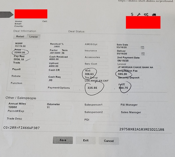

Just wanted to get your guys thoughts before pulling the trigger. How does this deal look? This will be the first car I’ve ever leased. I’ve learned a lot from this site!
MSRP: $35,776
Selling Price: $32,000
Cap Red: $2,836.18
Residual: 59%
Money Factory: 0.0013
Monthly Payment: $335 (after tax)
10k miles with 36 months
Any help will be greatly appreciated, thank you!

APR is 3.12%; Here is the printout
Effective $436/mo, don’t do that
@joeblogs Dealer said it will be $335.55 (including taxes) a month. Am I missing something?
About 4000 somethings
No offense, this is a car most here is a car you should probably look into buying cpo, new, or used.
Also effective means 0 down around here. This means that you are out of pocket your first months payment at signing and nothing else. The 4K is capitalized cost reduction + inception and dealer fees.
@mllcb42 Sorry for my newbness… This is my first lease. Is it because my $4,000 includes acquisition, first payment, taxes, and DMV fees? And if I only pay for fees then my monthly will be $436?
No, it’s because your $4000 is $4000.
Your total lease cost is $4000 + 35*$336= $15760
$15760/36 months = $437 / mo
@mllcb42 Thank you for the feedback.
So according to the dealer, the $4k I put down includes all the fees. Does that mean I’m putting down $2,836 outta pocket?
No, it means you’re paying $4000 out of pocket.
There’s really no need to dwell on how the $4k is broken down. You have to pay the fees one way or another. You either pay them or roll them in and then pay them.
@mllcb42 got it… So I’m guessing if I put $0 down, this isn’t a good deal because it will be $425 a month? Any recommendations on how I should approach this? Or is the type of car that isn’t the kind to lease?
