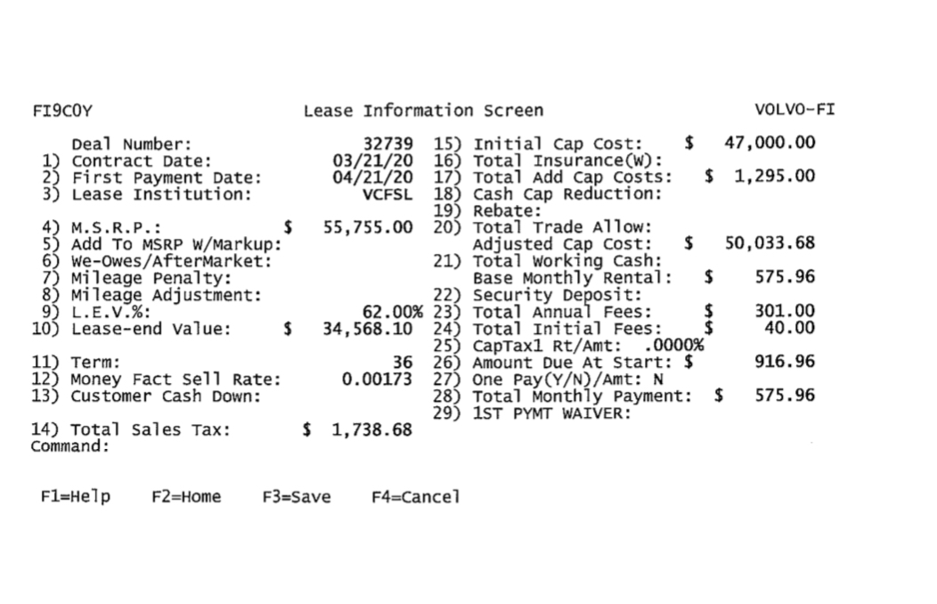

Trying to use the calc with the numbers I was given but not coming out as high as quoted. Thoughts on this deal? They say it’s the best they can do… I think there is some room here and figured I’d ask you all
Volvo leases are pretty easy to determine if you are getting a good deal. A good deal is 10+% off MSRP prior to incentives assuming base money factor.
Find out how much incentives are in your area, look at edmunds.
If you post a link to your calculator numbers, we can help find the discrepancy
Well, to start with, you have $1295 in incentives in your calculator where as the lease sheet shows $1295 being added to the cap cost. Those are opposites.
Also, you got rid of the acquisition fee and put in the due at sale there instead?

Yeah I’m just no good with understanding the numbers. Don’t even know what that fee is :joy: shouldn’t be laughing but trying to learn.
Appreciate the help w it
What did Edmunds tell you for MF/RV/incentives?
Says there is only l$1k rebate. No lease offers

There’s $2500 incentives on the t5 mom awd in chicago. Puts you at 11.2% off pre-incentive, which isn’t too bad.
Didn’t think I could get all of those. Appreciate you looking at this
Would love to get out the door under $550 or so. Has to be some room for them
