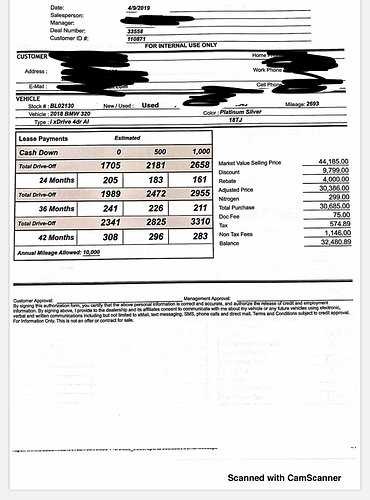

I signed one I. The first week of April same msrp for 280 p/mo (23 payments) no MsD and 0 DAS with 2600 miles I can share the sheet it might help?
Only extra incentive I had was college grad
if you can PM me the sheet would greatly appreciate it. Thanks,
Pmed.20202020
USAA is 250$
That’s about $150 a month too high for a 320i
Alit if ppl asking for the sheet here it is
They got you for 300 for nitrogen.
Nah got that taken off too when I went to the dealer lol
They said they couldn’t take it off so they discounted the selling price another 300 instead of taking it off so a total 10100 off

So I really don’t understand this. Looking at the sheet above, the final price isn’t much more. I know out the door price is sales.
But how could the lease amounts vary so much? It’s twice as much to lease the same car. I think taxes may be a little part of that.
The sales manager at this dealership said this was the lowest lease he’s ever seen in his 16 years at BMW :rofl:
I found a dealer in MN that is going to work with me on some of their leftover 18 now that the new incentives came out. He said he thinks he can get me a really aggressive lease, sounded more promising than anyone else I talked to anyway.
Out the door it looks like I’ll be under one or both of these sheets. So what am I missing? All the details for this sheet are in the original post. Any help on what I should be asking for or looking for to get down to the costs in the sheet above would be very helpful.
