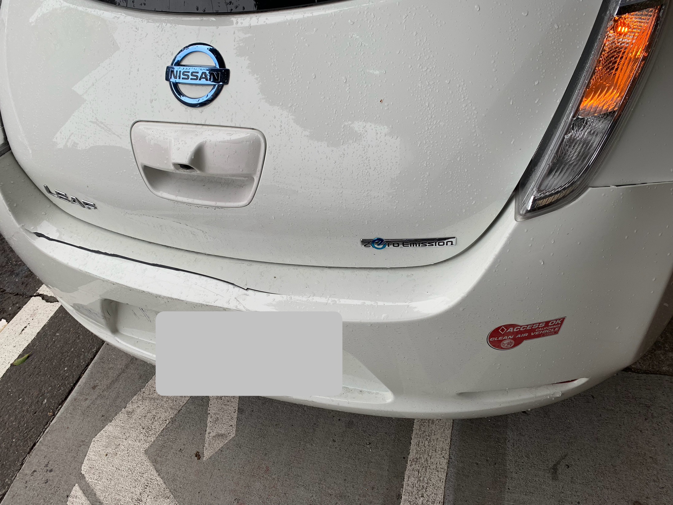

Had some one hit my Nissan leaf rear bumper years ago and repair came up to be over $6k.
It was bumper being hit, and rear lift gate slightly bent by the force due to how light and flimsy it was. Probably not all because of it being an EV but definitely due to how manufacturers try to reduce weight of the car to maximize range, or reducing cost due to price of batteries.
