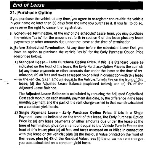

Oh by the way, the contract definitely has a 4% early buy-out fee and vehicle turn-in if fee under “Standard Lease - Early Purchase Option Price” clause
So that’s came up before and isn’t in all mb contracts. Seems to be state dependent.
