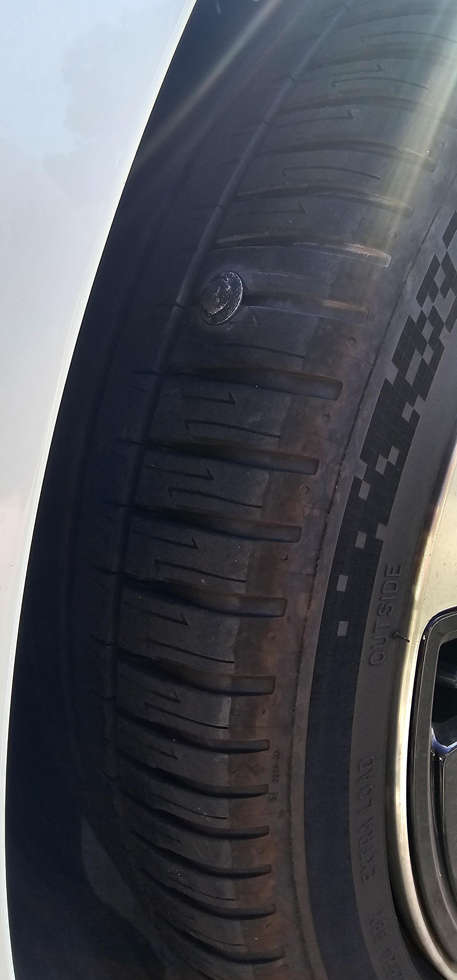

I got a nail stuck in my Lucid 20" Tire. Do you guys think it is repairable?
If not where can I get an alternative tire for an 18 months lease?
that’s close. Talk to your tire guy.
First guy said order a new tire for $500. The second guy at a different shop says it is fixable. So I left it with them. Let’s see what they can do.
yah the real part is when they look underneath and see if it is on the curve.
That’s close but far enough in that I’d feel comfortable patching it. Not a plug though, patch from the inside.
Yeah. The second shop was able to patch it without any issues.
Thanks
