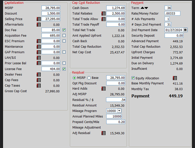

What do you think about 2023 BOLT EUV Lease
I’m in SoCal. Irvine area.
Here’s my target from the calculator for 2023 Chevy BOLT EUV
2023 Chevy BOLT EUV
MSRP: 28795
SP: 27067
RESIDUAL: 54%
MF: .00332917
36mo / 10K
Incentives 9500
The dealer sent me back this offer:
150/mo above the monthly payment I’m targeting.
I have a lease for a 2021 BOLT EV ending in January 2024 (190/mo)
Ask for $3,000 off MSRP maybe.
Well, it looks like they’re not passing through the $7500 lease but for an EV, so no surprise it’s high. People seem to have been getting killer deals on Ariyas?
Skip it and go contact @Jeff_BeachCitiesAuto for an Ioniq 5 or 6 and save money!
Even a Nissan Ariya 18m lease is less than this!
Purchase POS fed tax rebate if you qualify, starting next year.
Thanks for confirming what I thought was a terrible deal. :pensive:
I’m looking at the MB EQB300. They have a way better MF, plus the AMEX/SamClub incentives. Seems like I could get one for around $400/mo or less.
GM Financial programs for Bolt are not great. The rate is nearly 8% APR. If you’re going to lease, consider IONIQ 5 or ID.4. Or buy it outright and benefit from the $7,500 tax credit, if you qualify, for a sub-$20K car effectively.
