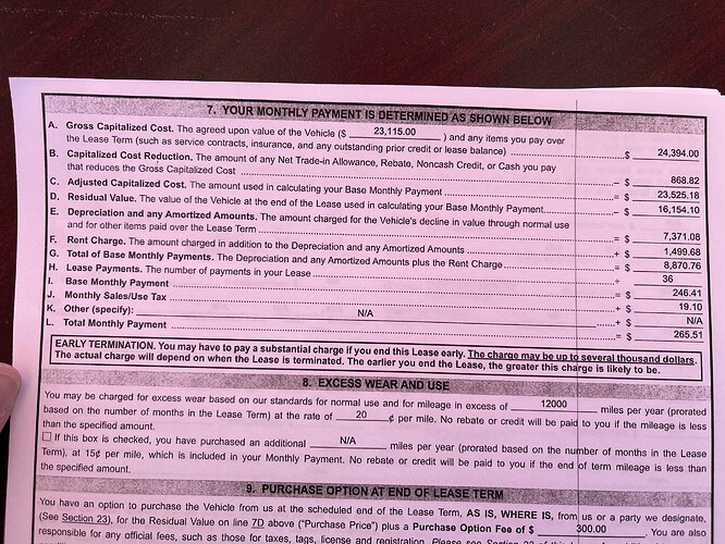

I tried to put on calculator but i guess i am still noob for it.
If you provide the MSRP, I can help you with the calculator
Edit: I’m feeling helpful today and figured everything out, but for 629 in additional charges (aftermarkets, perhaps?) that were capitalized to get to the Gross Cap Cost listed in your screenshots. I’ve added those to the selling price, leaving you with a 8.8% pre-incentive discount.
Not a bad deal at all. Enjoy your car!
26,055.00!!
Didn’t pay anything from first page btw.
It’s stated that the rebate covered your drive offs. That’s the only way to show your payment properly using the current LH calculator functionality
Just put the rebate in as an incentive and set to $0 drive off
I did try that at first. Monthly is slightly off.
Edit: I see now that if you put the rebate as a taxed incentive (even though it is untaxed per the deal sheet), that the payments then match…I guess this makes sense considering the LH calc would treat it the same way as CCR
Maybe try with 12,000k?
I corrected the calculator for the mileage, but the Residual I had in there was correct, so the numbers wouldn’t change. The current calculator above should be accurate
